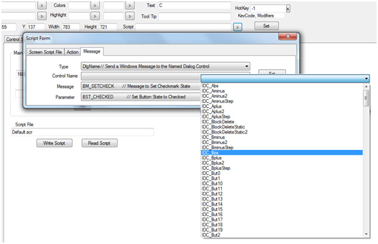

Buttons can be assigned to perform actions. Select a script that can either be a screen script or an action. We select an action type to set bit 46 to 1. Notice that this is the script that indicated that. For the other button, we select an action which sets bit 46 to 0. Now pushing the buttons will perform these actions. Save your new screen as a screen script file. Screen script is under the KMotionCNC directory and the sub-directory“Screens”. Configure KMotionCNC to use this new screen at every new startup.Notice that tool setup screen can be accessed by right-mouse clicking on the KMotionCNC title (in “Tools/Setup files”). Select the screen you just created.
Some more advanced features include input fields, C program actions, label DROs. Load the addition example in the screen editor. Example contains two user input controls and one DRO label control. The input edit controls are associated with KFLOP persist variables 160 and 161. The DRO label is associated with KFLOP persist variable 162. The Add button is configured for screen script action to run a C program in KFLOP. The C program is contained in the file “Add.c”. Test it by entering two values and pushing the Add button. Now open KMotion and look at the simple C code that is behind the function. (Open the file “Add.c”).

Using this field, the user has three options:
a) Selecting a screen script file from the library:
b) Selecting an Action:
