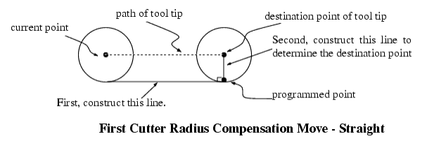

The Original EMC Entry Style type performed an immediate movement to a tangent point as shown below:

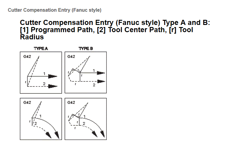

The New Fanuc TYPE A Entry Style delays movement of the entry move until a successive line or arc is specified.  It then performs the entry move to a position tangent to the beginning of the successive line or arc.  No gouging warnings or errors are generated.  The system assumes it is proper to move to the tangent point.  Only Type A is currently supported.

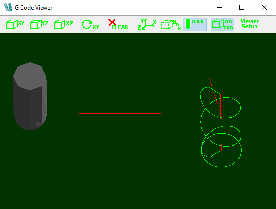

This GCode utilizes the Fanuc Entry style to perform a tight helix bore.  The code was designed for a nominal tool diameter of 0.194 inches
(T1 D=0.194 CR=0. - ZMIN=-0.2 - flat end mill)
G90 G94 G17 G40
G20
G53 G0 Z0.
(Bore2)
T1 M6
S2500 M3
G56
M8
G0 X0.563 Y0.
G43 Z0.18 H1
G1 Z0.1 F10.
G41 X0.5285 Y0.122 D1
G3 X0.4065 Y0. I0. J-0.122
X0.4071 Y0.0136 Z-0.0479 I0.1565 J0.
X0.7194 Y-0.0068 Z-0.124 I0.1559 J-0.0136
X0.4065 Y0. Z-0.2 I-0.1564 J0.0068
X0.7195 I0.1565 J0.
X0.4065 I-0.1565 J0.
X0.5285 Y-0.122 I0.122 J0.
G1 G40 X0.563 Y0.
G0 Z0.18
M5
M9
G53 G0 Z0.
G53 X0. Y0.
M30
Here is a Plot of the result:
Orthogonal Top View
