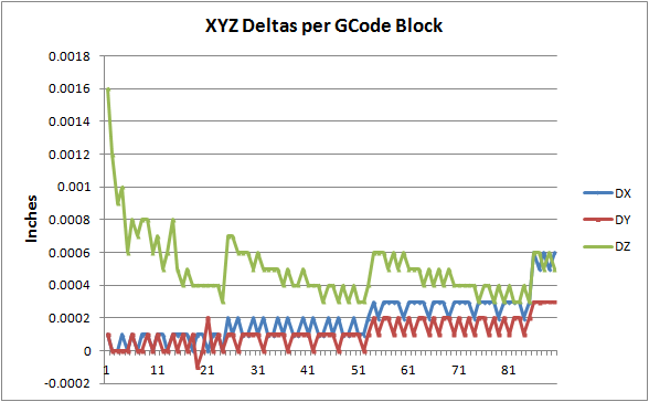

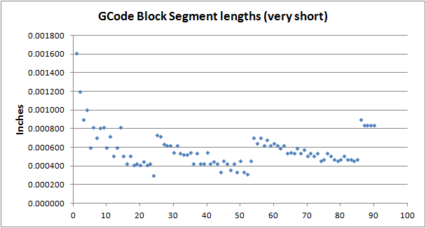

The 3D XYZ Segment lengths are very short and plotted here:
The XYZ deltas show significant qunatization errors caused by being so small and only the 4 decimals of precision.

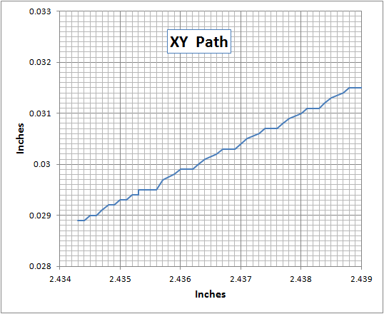

XY View of the 3D Path. Grid spacing is 0.0001 which is the resolution of the GCode. Notice the Quantization to the grid points causes 90 degree angles in some cases because the vector lengths are so small.

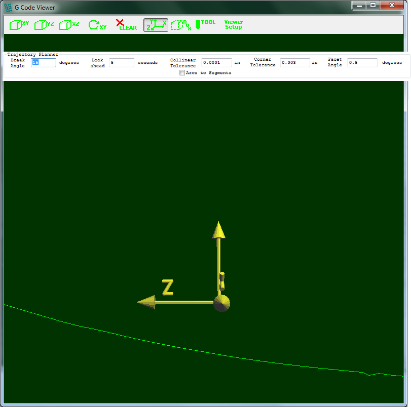

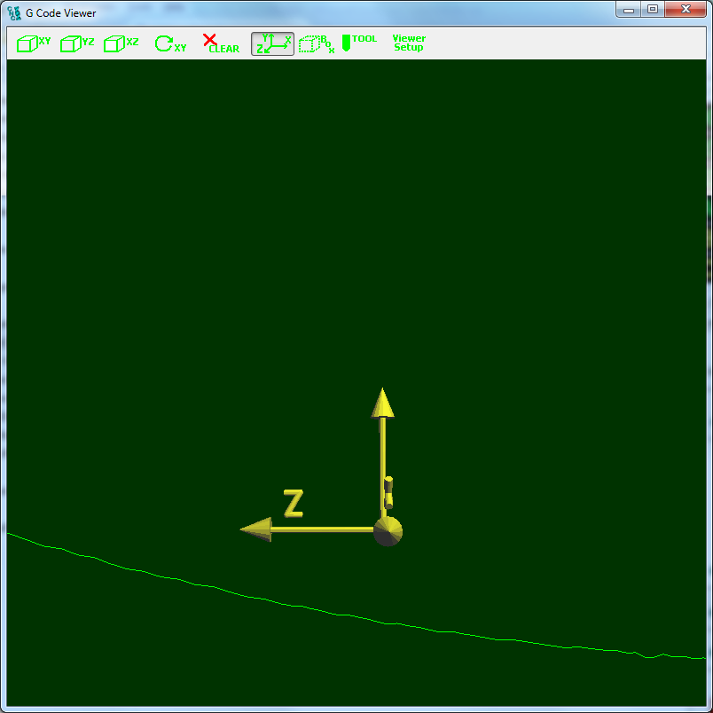

Here is an extreme zoom in of the GCode plotted in simulation mode which performs no Trajectory Planning or smoothing. Note the "zig-zag" motion along the path.
These Trajectory Planner settings shown have too small of allowed Collinear Tolerance to allow the Trajectory Planner to smooth the path. A very small or zero tolerance forces the Trajectory Planner to closely follow the originally specified GCode path. Because the resulting path is not smooth and angles > than the specified Break Angle limit of 15 degrees remain, exact stops occur at some points along the path.

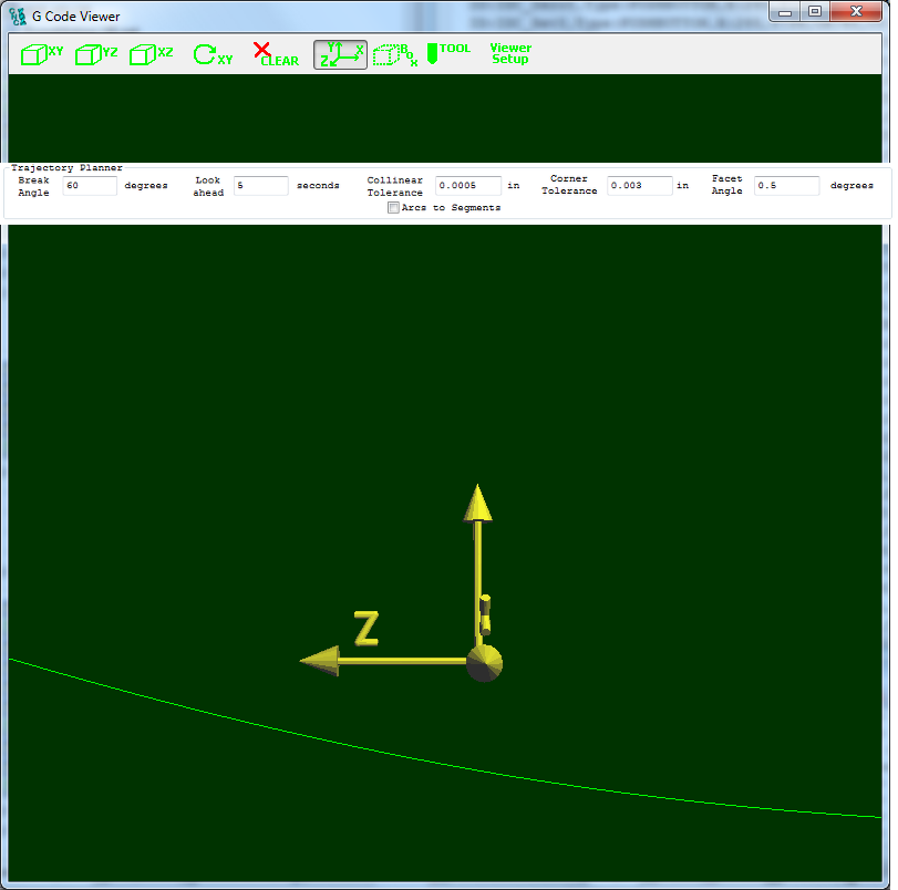

Here the Collinear Tolerance has been increased to 0.0005 inches to allow more smoothing and the Break Angle has been increased to 60 degrees to avoid exact stops. The resulting motion is now smooth without stops.
