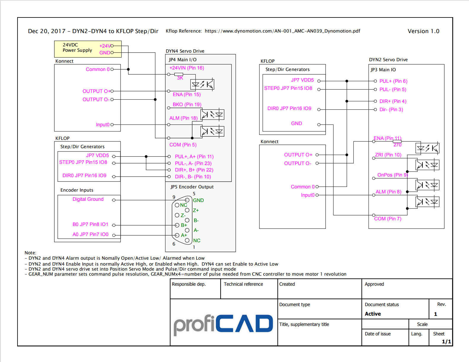

For my application I will use the DYN4s in position mode with puls/dir control. I want to use the encoder out to the Kogna for better accuracy rather that the brains of the system only relying on the alarm output. Hope I'm explaining this right.
DMM Tech. only has the wiring for Kflop, but I'm sure this will translate to the Kogna easy enough.

Hi Mick,

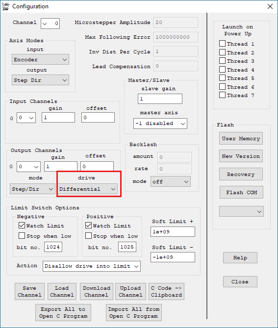

That wiring would work but since Kogna has 5V differential drivers and receivers it would be better to use those instead. See here.

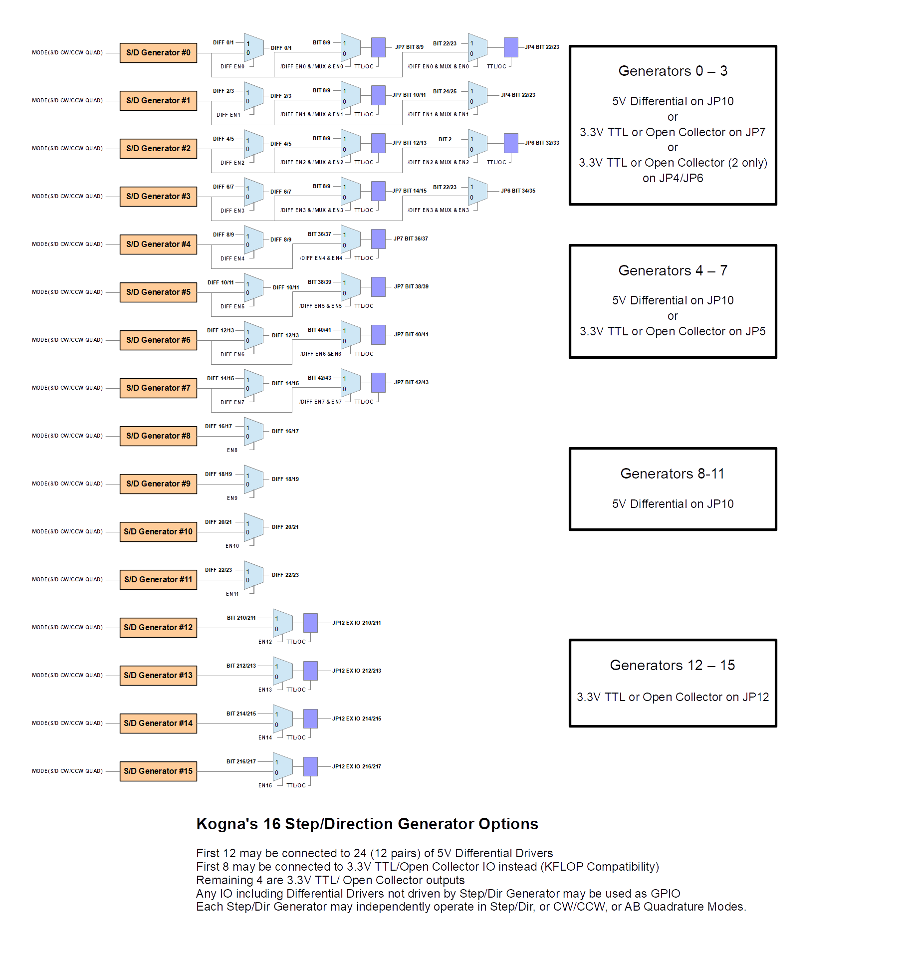

The first 12 of Kogna's Step/Dir Outputs can be directed to Differential Outputs on JP10 and JP14
Select Differential on the Configuration Screen

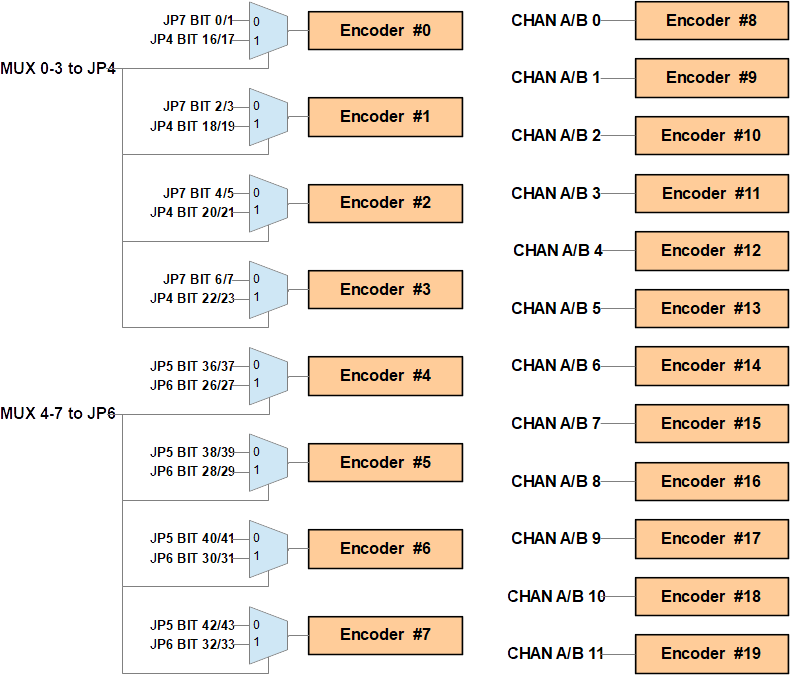

Encoder inputs 8 through 19 are connected to Differential receiver inputs on JP8 or JP14. See here.
