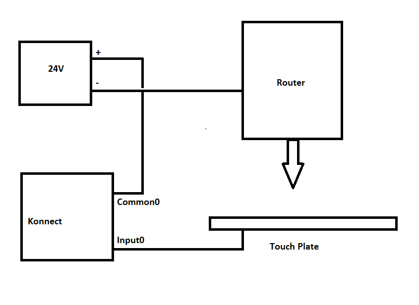

I require assistance with connecting the following CNC X-probe to KFlop/KStep.

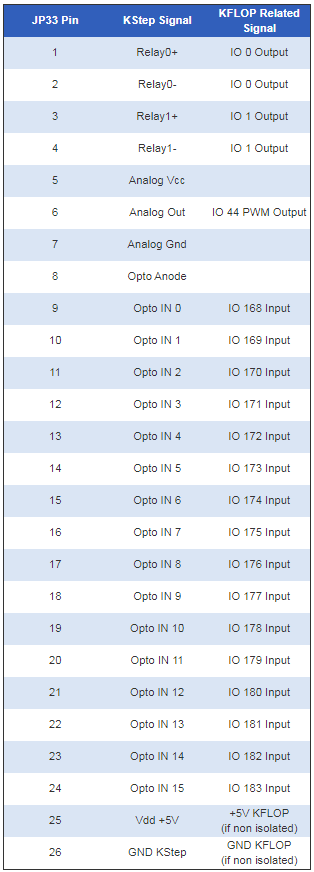

It shows a Konnect Input used but a KStep Opto Input could be used instead. See KStep's Optically isolated Inputs described here. Opto Anode would correspond to Konnect's Common0.

So in accordance with this link below, I could use "JP33" and the pin 8 and then choose an unused pin between 9 and 24. Is that correct?
