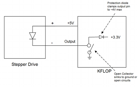

Checking to see if anyone has had good success with Leadshine stepper drives. I am using 6 closed loop mode with encoder feedback directly into the KFlop. I am looking a the model below and see that the voltage requirements are:
"Direction signal: 5V signal, differential input. High input is 4-5V, Low input is 0-0.5 V. Minimum pulse width = 2.5 µs"

KFLOP doesn't strictly meet those voltage requirements. To meet the specifications an external driver would be needed.
The Timing should be ok. Its best to use CW/CCW (or Quadrature) whenever available as it eliminates most all of the timing issues that exist with Step/Direction modes. But it seems that model doesn't support any of those.
1. Would I have the best luck running on "Open Collector - Step/Dir" or "LVTTL - Step/Dir" mode?
Open Collector mode normally works best. It should provide a High input of more than 4V when KFLOP is sinking to GND. But the Low Input would be greater than 0.5V. See the circuit below that shows clamping to the 3.3V Supply. This results in approximately:
5V - (3.3V + 0.4V) = 1.3V
Because the LED in most opto couplers require at least 1.4V to begin to turn on this usually works ok even though not meeting specification.
