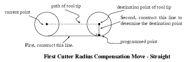

Fanuc vs EMC/NIST Radius Compensation Entry Move Styles
A new Fanuc Style Radius Compensation Entry Move has been added.  To Select which type of Entry move should be performed add a setting to the GCode Interpreter Settings file as shown below.  KMotionCNC specifies the GCode Interpreter Settings File to be used in the Tool Setup | Setup Files section.  The first value after comp_entry_style will be the selected type.
comp_entry_style        FANUC_COMP_ENTRY_STYLE        EMC_COMP_ENTRY_STYLE
The Original EMC Entry Style type performed an immediate movement to a tangent point as shown below:
The New Fanuc TYPE A Entry Style delays movement of the entry move until a successive line or arc is specified.  It then performs the entry move to a position tangent to the beginning of the successive line or arc.  No gouging warnings or errors are generated.  The system assumes it is proper to move to the tangent point.  Only Type A is currently supported.
