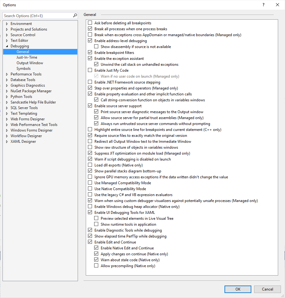

If Visual Studio skips over Unmanaged code calls and refuses to step into the Unmanaged functions you may have some odd Visual Studio debug options set.  Exit debugging and within Visual Studio use the Debug | Options | Debugging | General and select options as shown below:
Note one disadvantage of having native code debugging enabled is that Visual Studio's powerful Edit and Continue option to make changes on-the-fly is not available.  So when not necessary to debug into Unmanaged code it is may be desirable to disable native code debugging.
