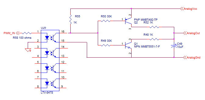

No, but you can connect Konnect to JP4 instead to free Up JP6.
Here is an example using software, 2 Konnect Outputs, and a simple circuit to create an opto Isolated Analog signal. Response rate is not great but adequate for most applications.

You might copy our KStep/KNozz PWM to analog circuit
i have built this circuit already, i am trying to find out how to configure an output as PWM from JP6, do i need a C program for that?

PWM Output Mode for an Axis is not directly supported. A C Program can be used to have the Axis Output directed to a PWM in the mode necessary for your system. See the "Setup Gcode 4 axis PWM signMag.c" example.
Or to just output the GCode S value to a PWM see the SpindlePWM.c example.
