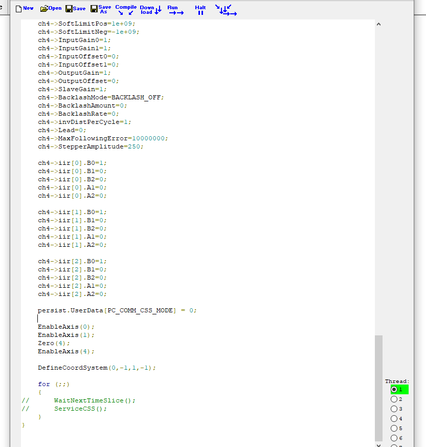

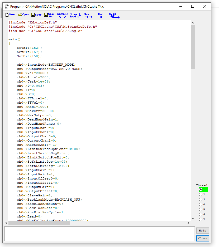

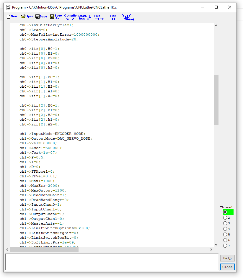

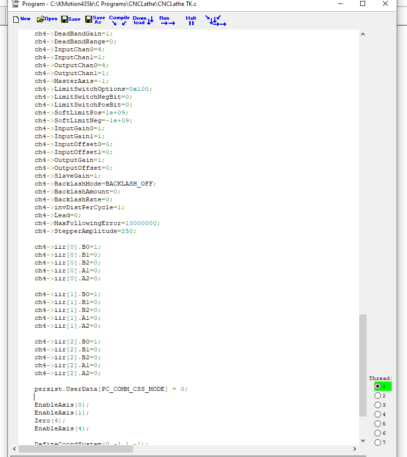

I know you have to respond to many questions every day and thus you probably would not remember, but my second post in this exchange says the same thing about the spindle. It worked after you tuned it up when you had control of the computer. Now it does not and I have not messed with any of the programming since you finished, and have not changed any connections in regard to it. I also mentioned my other lathe you tuned a couple of years ago does the same thing. It accelerates to a high speed as soon as kmotion is initialized , then slows to a stop, reverses and goes the other direction and continues this cycle a few times getting less force full each time and eventually settles down to zero speed and is then good for the rest of that initialization cycle. This lathe cannot complete this action because it does not have enough supply power to accelerate that quickly. The DC drive trips out. I will attach the copy of the TK C program here. Please let me know if you want to see any other programs under the CNC Lathe main file.

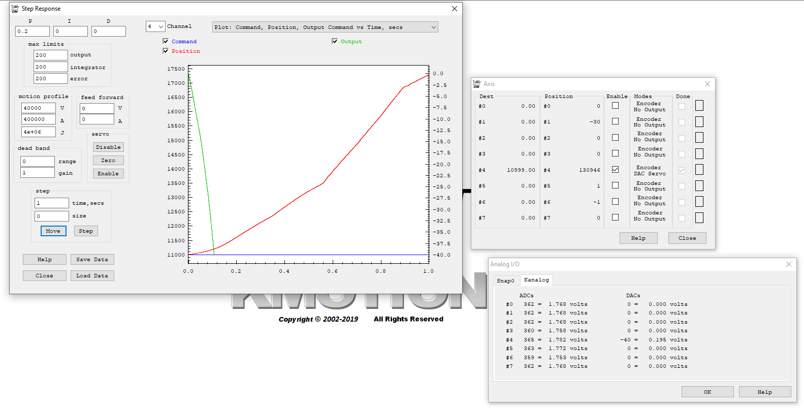

Hi Tom, Your item #1 import into kmotion. Just want to make sure I did this right. I opened the channel setup screen, input chanel 4 at top,then with the C program open I pressed the import all from open program. I got the 3 axis found message 0,1, and 4 . Pressed the import all from open C. If that was not correct then I did not do what you wanted. The step response buttons did then work in so far as enable, zero and move. For some reason as soon as I enable I get a voltage output. If I disable it goes back to zero. If I push the move button with 0 move I get the same 40 as you see on the axis screen and the spindle moves even though it is a zero move. Hope I have attached all you want to see.

That looks to be classic positive feedback runaway with the motor driving away from the target making the error larger rather than toward the target to make the error smaller.
Limiting the Error to 200 and with only a P Gain of 0.2 limits the Output to 200 x 0.2 = 40 DAC counts. So the DAC quickly goes to -40 and remains there.
Reverse either the InputGain0 or OutputGain0. The first will reverse the direction the encoder counts the second will not.
