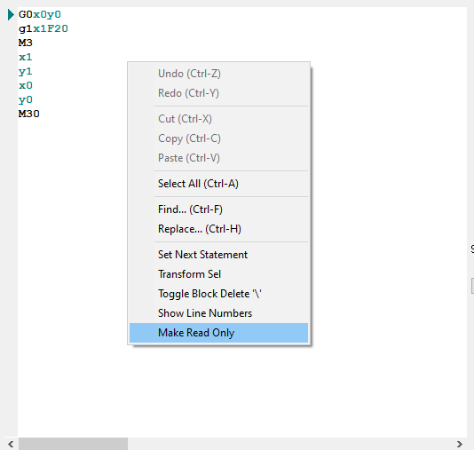

2. Is there a way to lock the kmotion gcode screen with password so that noone can edit the gcode?
Not with a password. But if you right click on GCode Control there is a Make Read Only option
Furthermore using a Screen Script you can set the Var parameter of the GCode Control to 2 to make it permanently read only. The values of Var are:

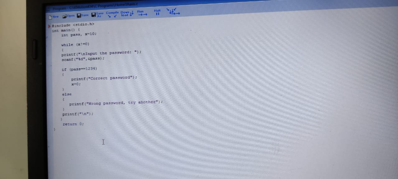

normally i have been used the following c code for password authentication . but you suggested when the password is correct ,set the var parameter to 1.but i cant find the variable used to set "var parameter".

Well no, scanf isn't supported. See the MessageInputBox.c example of how to ask the Operator for a value.

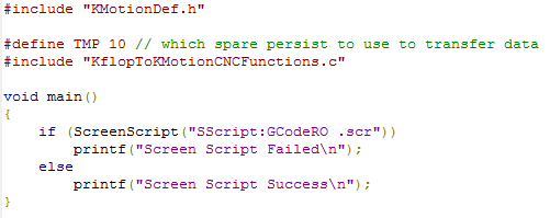

I tried to change the gcode screen in the kmotion cnc via c program in the below
ro ss.PNG (7.96 KiB) Viewed 3597 times
i had executed the program by defining it as a button.

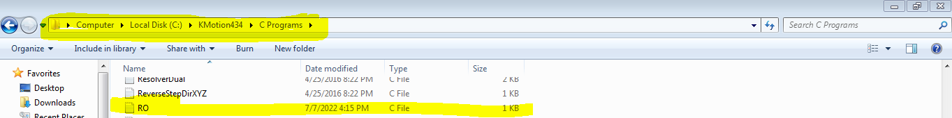

when I executed the program i got the below popwindow.
KFLOPtoKMotionCNCfunctions.c must be in the same folder as the C Program to be found if no path (absolute or relative) is specified.
yeah its in the same folder

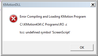

Re: Modbus communication with HMI eliminating the PC
Posted: Thu Jul 07, 2022 4:44 pm
by TomKerekes
It seems you are still using V4.34.
