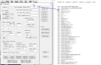

Thank you for answering so quickly. I looked... also there were questions. Can you give me an example of such a connection?
- Posts: 2892
Post
by TomKerekes » Mon Jan 27, 2020 6:50 pm
Hi Igor,
You would need to wire the encoder to a KFLOP encoder input.
The Output Mode would be CL Step not CL Micro. Microstepper Amplitude would not apply as your drives control the current. See
here.
Don't concern your self with a C Program at this time. Use the KMotion Screens.
Igor

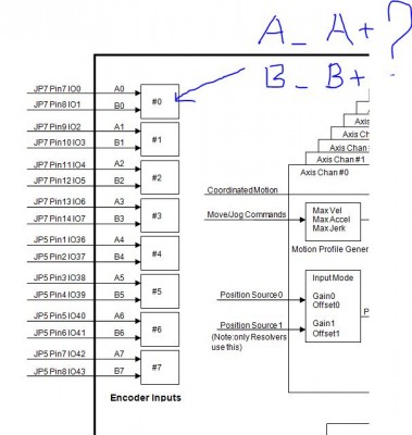

I do not understand how to connect pins A, A +, B, B+
- Posts: 2892
Post
by TomKerekes » Tue Jan 28, 2020 1:45 am
Hi Igor,
As I said before to connect differential encoders with A+ A- B+ B- to single ended inputs with only A and B, just connect one of the A and one of the B and leave the other two signals unconnected. Note this will be more susceptible to noise than a differential input that uses all 4 signals.

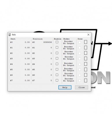

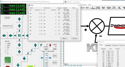

by Igor » Wed Jan 29, 2020 5:06 pm
good afternoon Tom. I 'm getting a mistake. Connected the ruler to pin7-8, often the axis to become yellow is the reason and how to eliminate it. After reloading, the position is inadvertently counted. thanks
- Posts: 2892
Post
by TomKerekes » Wed Jan 29, 2020 5:35 pm
Hi Igor,
For us to help you would need to tell us exactly how things are configured and what you are doing.
You should get everything configured, tuned, and tested in KMotion.exe before attempting to use KMotionCNC.
I suspect your
Axis Resolutions in KMotionCNC | Tool Setup | Trajectory Planner | Axis Parameters is not set properly. If they are set at zero then trying to use them to convert from counts to GCode units will result in a division by zero. See also
here and
here.
