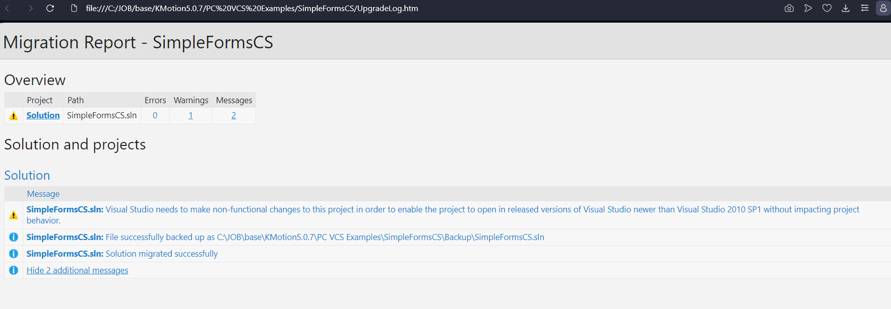

It seems that I am unable to launch SimpleFormsCS as well, the same error. I try it on Visual Studio 2022 17.9.6. When I first open solution of the example you provided, namely SimpleFormsCS, it asks me to migrate to newer version of visual studio something like that, and then gives me the migration report. In properties it says the target framework is .NET Framework 4.8. As I now remember, on PC I had the same problems, when I tried to add reference to Kmotion_dotNet.dll on newly created projects, but on my PC SimpleFormsCS worked (on laptop even SimpleFormsCS doesn't work), so I basically remade your example project from the scratch. And now when I copy the same project to my laptop, it again has this error. I will try things recommended on the thread you linked me. If you have more recommendations for me based on information I provided you above, I would greatly appriciate it.
