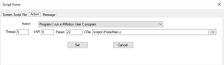

Additional Screen Script Button Actions are created dynamically and do not have an index so the index is passed as -1 to indicate this. In this case the Action places the 3rd floating point parameter of the Action into the Persist Variable. This allows the C Program to receive a parameter which could be used to identify the Button or be used as a parameter for example as a distance to move.
Here a value of 22 is passed to cause a probe of type 22.
