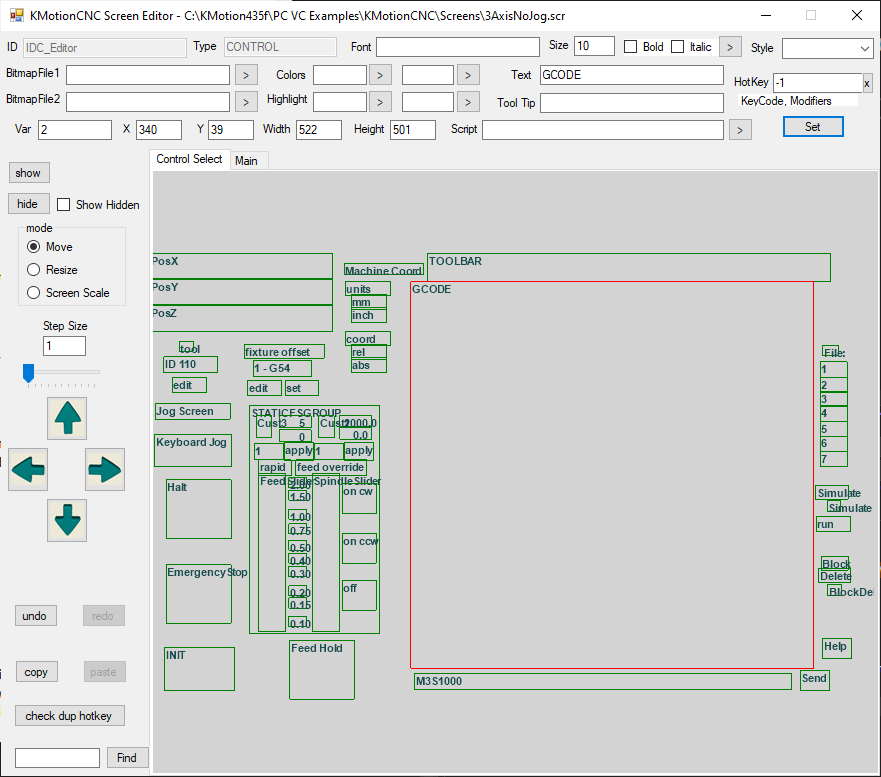

hi Ajith ,
Furthermore using a Screen Script you can set the Var parameter of the GCode Control to 2 to make it permanently read only. The values of Var are:
-1 = default behavior allow the Operator to change (R/W on startup)
0 = Set Read Only and allow the Operator to change
1 = Set R/W and allow the Operator to change
2 = Set Read Only and do not allow the Operator to change
I suppose you could set 2 for read only and then add a User button to run a C Program to ask for a password and if correct set to 1 using screen script.
C:\KMotion435f\C Programs\FlashNonVolatile\FlashCoordMotionBuffer\
Well no, KMotionCNC runs on a Windows PC1. Is it possible to communicate with any HMI (via modbus also) and operate with kmotion CNC without using Computers?

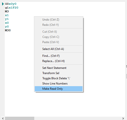

Not with a password. But if you right click on GCode Control there is a Make Read Only option2. Is there a way to lock the kmotion gcode screen with password so that noone can edit the gcode?

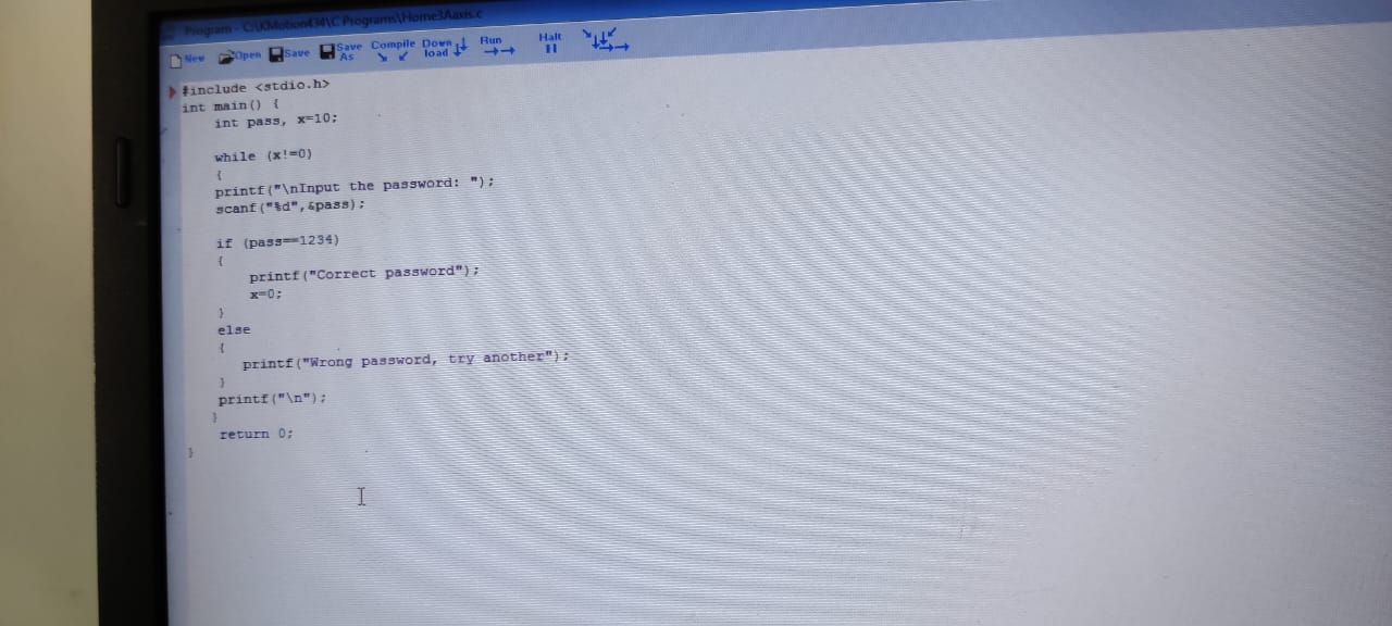

Respected Sir,
normally i have been used the following c code for password authentication . but you suggested when the password is correct ,set the var parameter to 1.but i cant find the variable used to set "var parameter".Furthermore using a Screen Script you can set the Var parameter of the GCode Control to 2 to make it permanently read only. The values of Var are:

Well no, scanf isn't supported. See the MessageInputBox.c example of how to ask the Operator for a value.
To change Var (or any parameter of a control) you can re-define it with the changed parameter using a screen sub-script. See the attached two screen SubScript files. One sets the Edit Control to Read Only and the other to Read/Write. Also two C Program examples on how to execute the SubScripts.

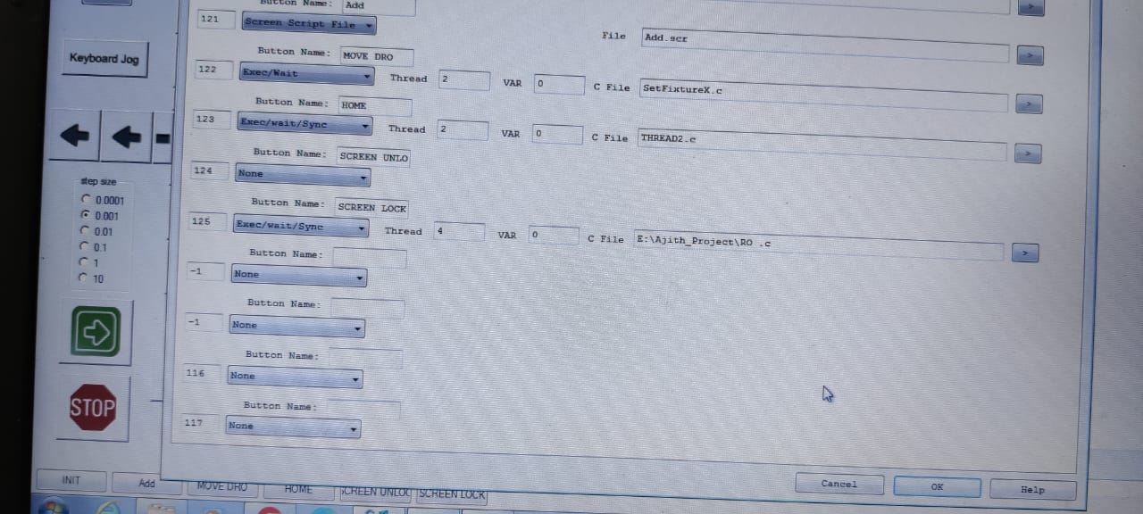

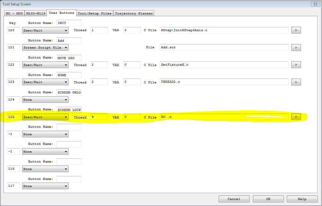

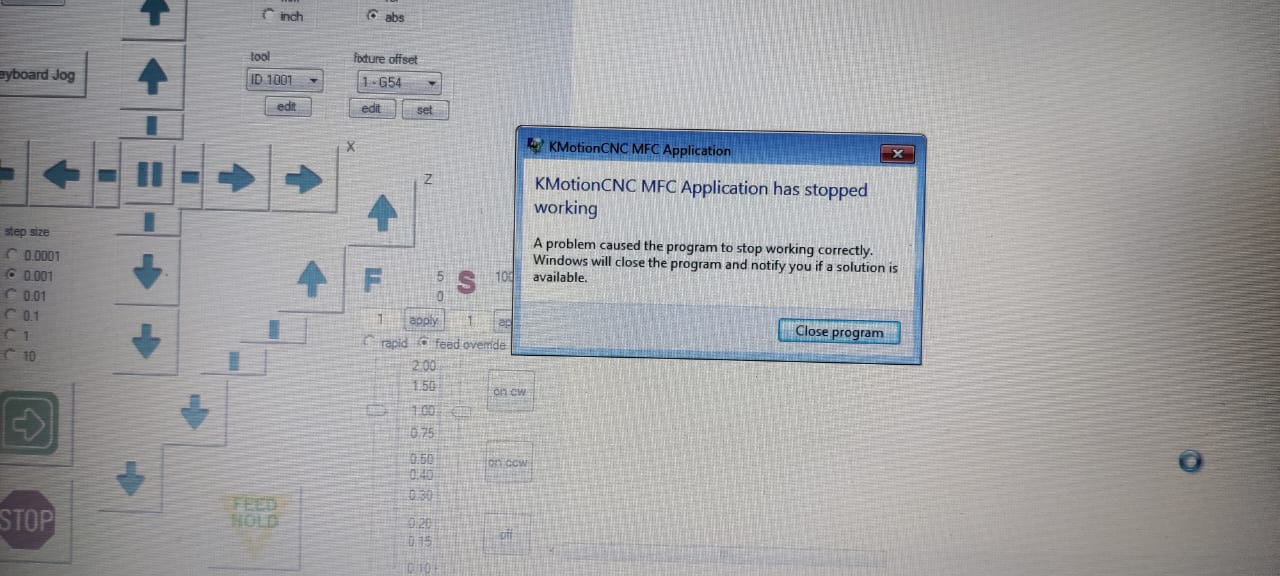

Re: Modbus communication with HMI eliminating the PC
Respected sir,
I had tried the subscript and c program and got the following error. when i defined the subscript directly as a button and execute the subscript by pressing the button i got the below popmessage the kmotion cnc application got closed automatically. next i had tried the c program that you had send. i got the following error popped up. i also checked the C program in dynomotion application and got the same error that "KflopToKMotionCNCFunction" not found i also tried the way to get password but i can get the value from keyboard but i cannot compare the value in if clause the execute remaining program.
- Posts: 2927
Please use Version 4.35f.
Please grab screen shots with Alt-Print Screen rather than photos.
It looks like you have extra spaces in the filenames.
KFLOPtoKMotionCNCfunctions.c must be in the same folder as the C Program to be found if no path (absolute or relative) is specified.

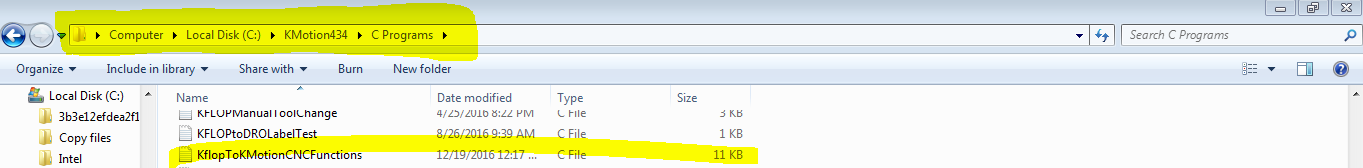

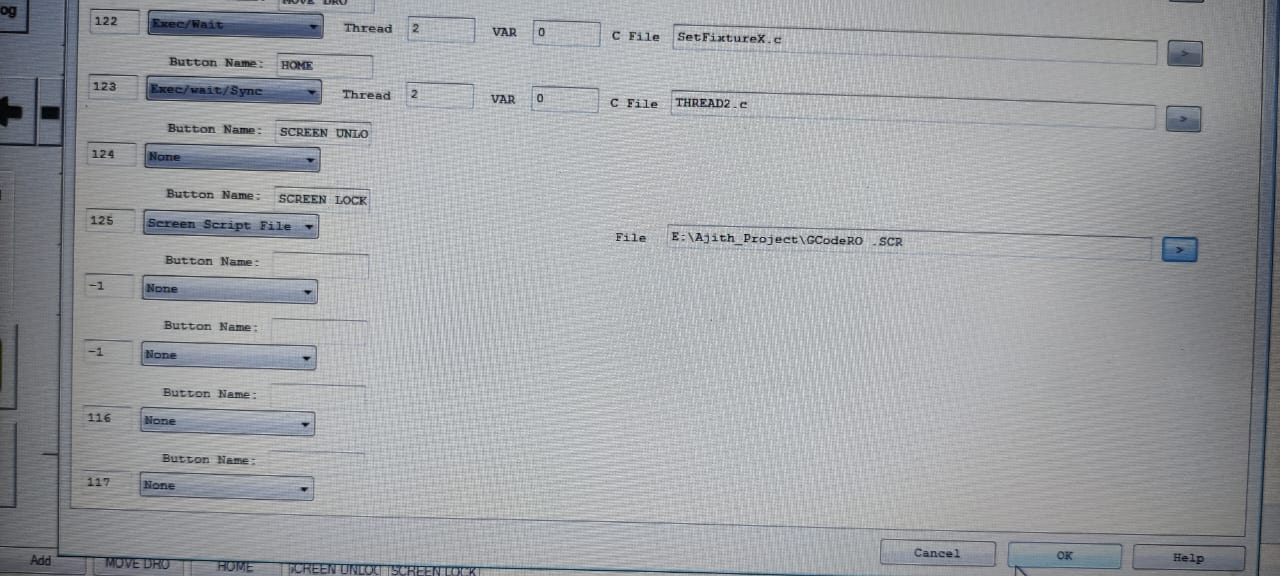

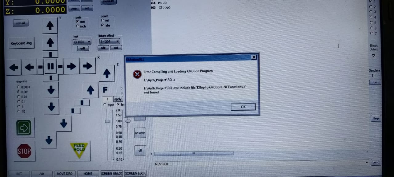

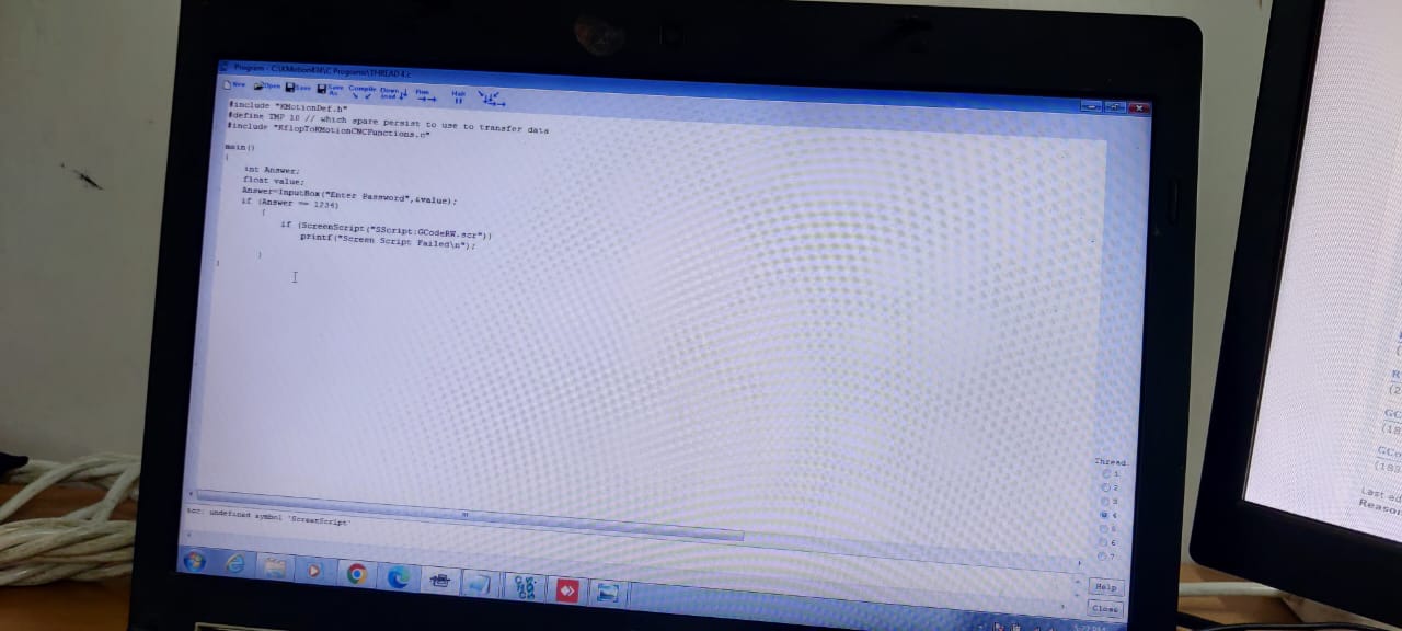

Respected sir,
I tried to change the gcode screen in the kmotion cnc via c program in the below i had executed the program by defining it as a button. when I executed the program i got the below popwindow.
yeah its in the same folderKFLOPtoKMotionCNCfunctions.c must be in the same folder as the C Program to be found if no path (absolute or relative) is specified.
- Posts: 2927
It seems you are still using V4.34.
