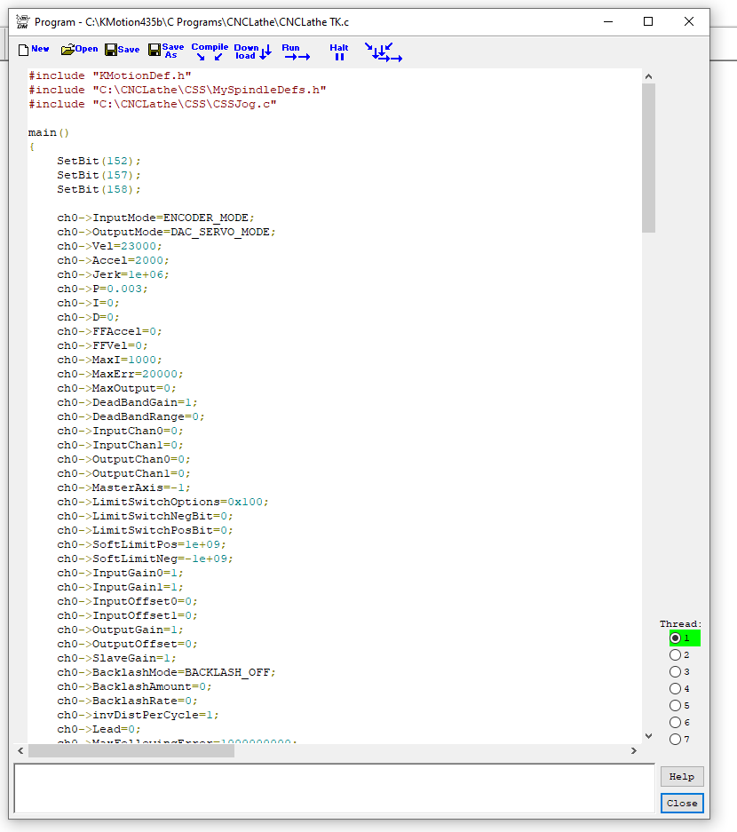

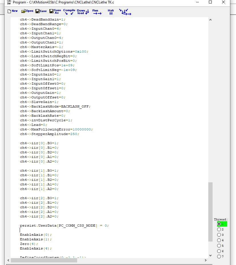

I know you have to respond to many questions every day and thus you probably would not remember, but my second post in this exchange says the same thing about the spindle. It worked after you tuned it up when you had control of the computer. Now it does not and I have not messed with any of the programming since you finished, and have not changed any connections in regard to it. I also mentioned my other lathe you tuned a couple of years ago does the same thing. It accelerates to a high speed as soon as kmotion is initialized , then slows to a stop, reverses and goes the other direction and continues this cycle a few times getting less force full each time and eventually settles down to zero speed and is then good for the rest of that initialization cycle. This lathe cannot complete this action because it does not have enough supply power to accelerate that quickly. The DC drive trips out. I will attach the copy of the TK C program here. Please let me know if you want to see any other programs under the CNC Lathe main file.

Hi Scott,
Please attach the C Program as a .c file rather than photos of pieces of it.
To see what is happening please do do the following:
#1 Import into KMotion All the settings from the C Program
#2 On the Step Response Screen select axis 4
#3 On the Step Response Screen Push the Zero button.
#4 On the Axis Screen observe the #4 Destination and Position. Are they Zero?
#5 On the Step Response Screen set the size to 0 and Push "Move" to configure and enable the Axis
#6 what did the Spindle do? Is the Spindle enabled?
#7 post the Step Response Screen and the data
