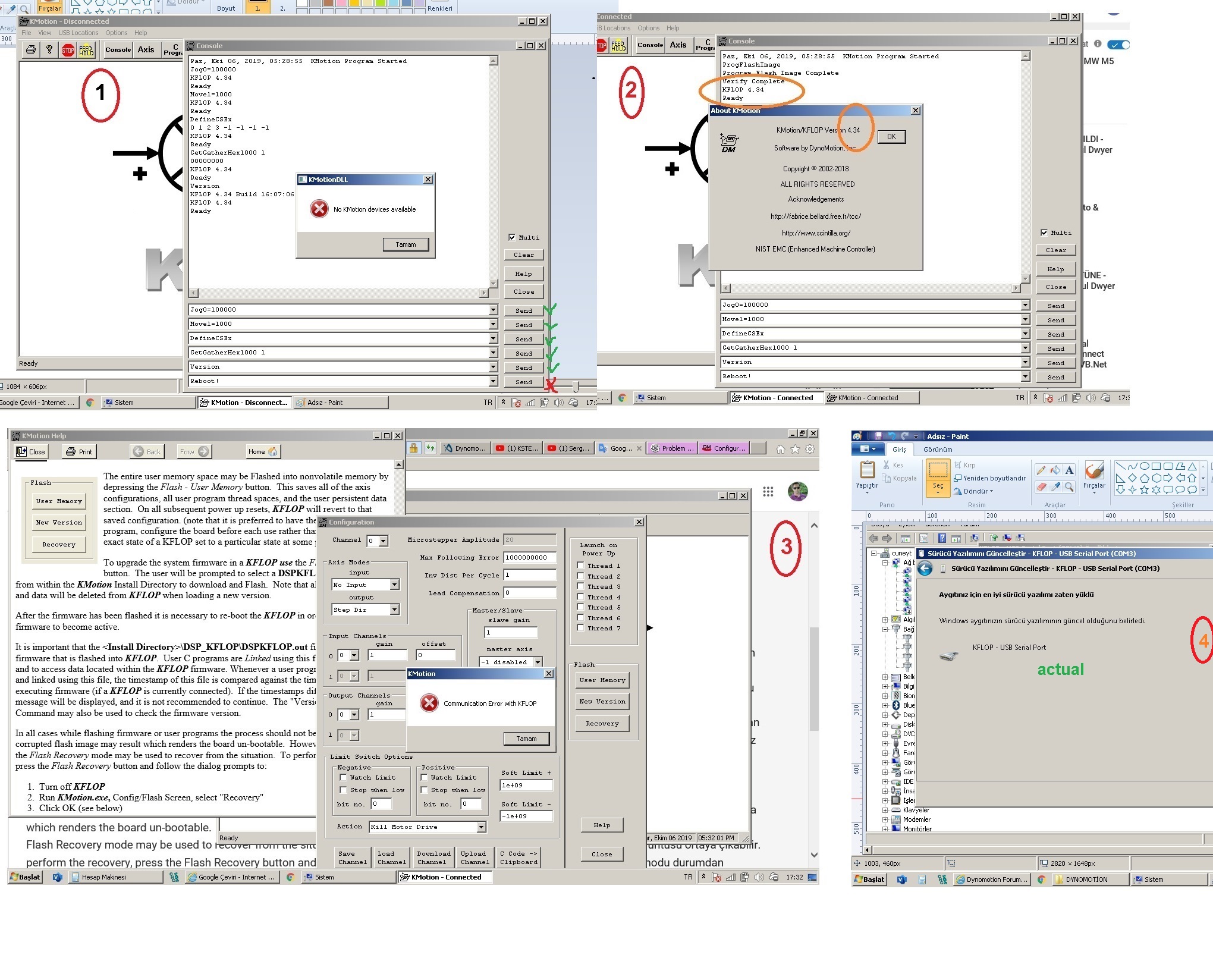

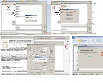

Post by cnytbsk » Sun Oct 06, 2019 3:40 pm
Hi Tom.
I added my problem. I readed pdf. I m not connected Kflop. ( I try, 12 days not working )
I prepare owm 3 axis puls dir c program. ( for stepper motor).
I watched many time kstep KSTEP Introduction - (Getting Started with KSTEP Stepper Driver)
Where can write per step ( I realdy don t undertand that)? I know acceleration and velocity.
Thanks for e stop c program
// if ESTOP present disable any enabled Axis ??
#define ESTOP_BIT 180
if (ReadBit(ESTOP_BIT))
I dont understand
which connector suitable for it ? JP ?
PİN Number? (I don't understand how to map bit 180 to pin)
how it should wring?
Many thanks
I don't understand what you are doing or showing. It seems communication is working and you have V4.34. So I don't understand what problem you are trying to solve. When you reboot KFLOP it is normal to lose communication. You should not need the Serial COM Port Driver.
I don't understand the question. You can set the axis resolution of counts/inch in KMotionCNC | Tool Setup | Trajectory Planner | Axis Parameters. Note for a stepper system counts=steps.
