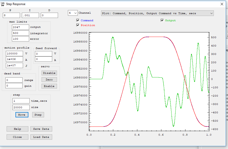

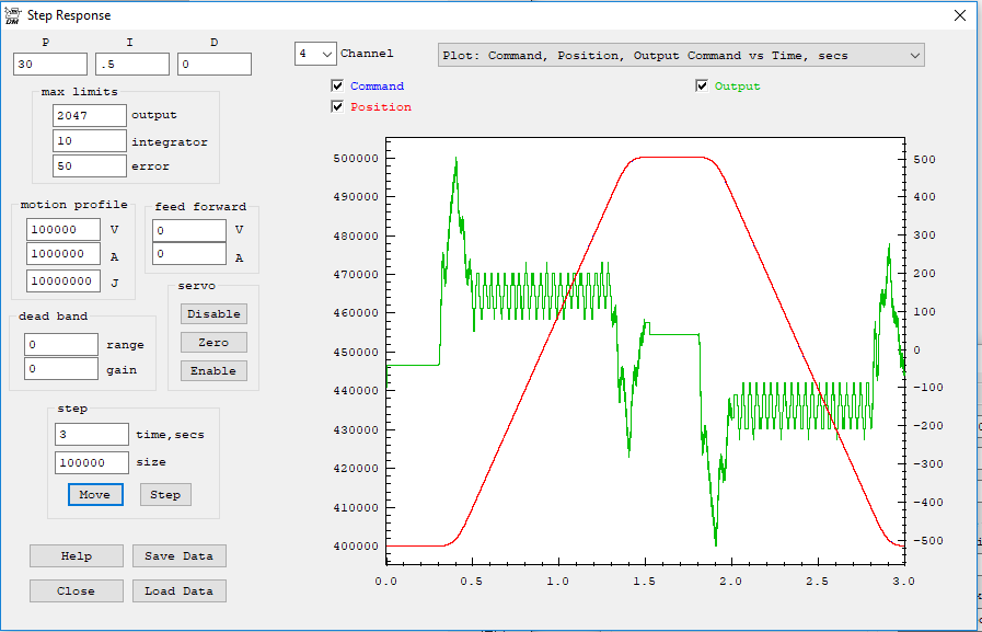

I have also attached a screenshot of the step response screen from the 4th axis. The output looks very different than the other ones...don't know if this is due to it being rotary?

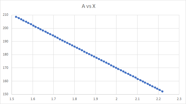

I've never seen CAM output bursts of short Rapids like that. KMotionCNC only combines/smooths Feeds not Rapids. Rapids will be handled as 3rd order exact stop type of moves. I can't imagine why the CAM would do that. Especially since they appear to be forming a perfectly straight line. The CAM looks to be limiting the rapids to less than 1 degree of motion. For example starting at line 195 (see below). All the intermediate Rapids should be able to be removed at no consequence. Here is a plot:
Your tuning looks reasonable. I can't really see what the error is at that scale. It is better to plot error when the errors are small. Also post the raw data so we can re-plot ourselves.
The Integrator Gain is probably way too high, but then it is limited to 10 DAC counts so is effectively turned off. So it would be better to reduce the I gain to something like 0.001 and increase the Integrator limit to something like 500. But I doubt if that is related to the issue you are having.

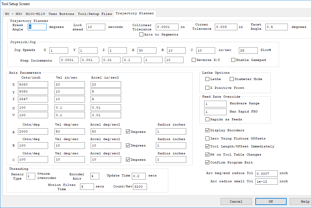

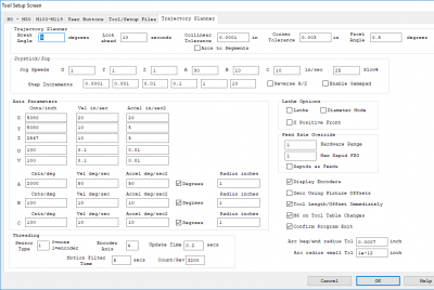

And here's the Trajectory planner.

Regarding Trajectory Planner:
Increasing Break angle to 179degrees is usually best for no stops (everything is rounded)
Radius for A Axis of 0 will make feedrates dependent on XYZ only.
Collinear Tolerance seems unnecessarily small
