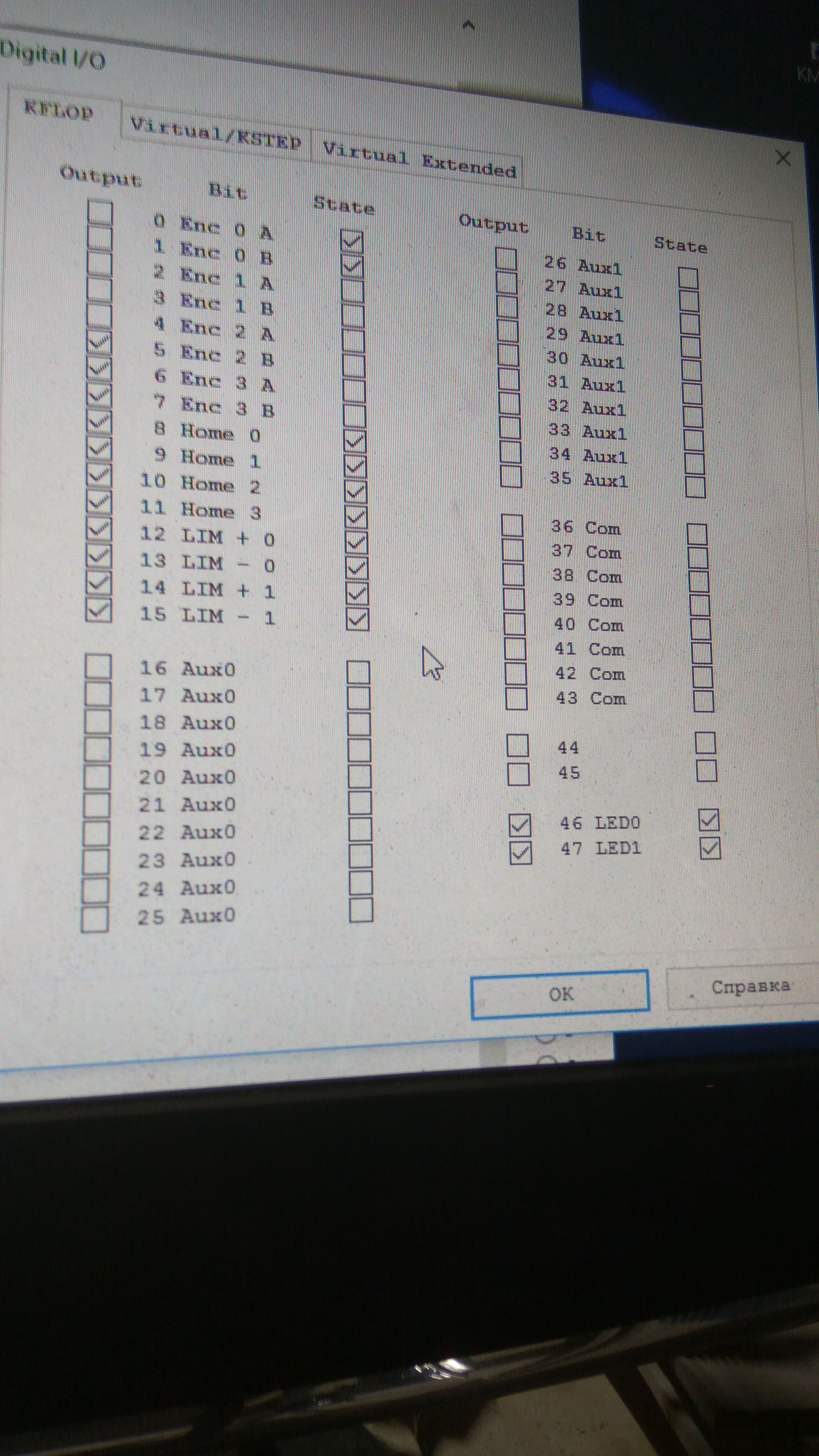

Maybe it's a dumb question, but I've spent 2 evenings trying to solve it. After some manipulations with "smooth mpg" programs IO0 pin has 3.3v on it, though It's configured as Input, both in INIT program and via command in console. At IO screen it has the checkbox 'state' checked, as shown in attached screenshot. Before messing with MPG (by the way I could'nt configure it properly) IO0 was an input for Z home sensor and worked well. I've tried 'SetBitDirection', "SetBit, 'ClearBit', even "ClearBitBuf' - still no luck.... And last but not least - now IO0 and IO1 work in pair - for example if I check the box 'output' for IO0 it gets checked for IO1 automatically. What could be the problem?

That is probably normal. KFLOP inputs have very high impedance (meg-ohms) so an input not connected to anything can float to any voltage. Also there can be some small parasitic capacitance between traces on the board or wires in your cable that may cause one signal to change if an adjacent signal changes if the first signal is floating and undriven. An input should only be considered meaningful if it is connected to something that drives the pin high or low.
To test the inputs connect them through something like a 1K ohm resistor to either GND or +3.3V. The measured input voltage using a voltmeter should measure within several tenths of a volt to what it is connected to and the Digital IO Screen should change appropriately. Driving both inputs at the same time, to all 4 possible states, should work correctly.

Thanks for your reply. The problem is that this input IS connected via optocoupler board to Z Home proximity sensor (NPN), and when I try home Z, Kfop sees 'high' on input and zeroes the axis right in the place. Another strange behaviour is when I check the box 'output' on DigitalIO screen for IO0, checkboxes 'state' is deactivated both for IO0 and IO1, is it normal?

Well a normal open-collector type of NPN output will only drive the pin low and not high. When not being driven low it may float to any level and report any state. But that problem would result in the state being low when it should be high not what you describe. Although it also depends on how you have the sensor wired. Please check the KFLOP inputs for correct operation with the test I described in my previous email. That will help isolate whether the KFLOP inputs have a problem or if the way you are driving them is a problem.Thanks for your reply. The problem is that this input IS connected via optocoupler board to Z Home proximity sensor (NPN), and when I try home Z, Kfop sees 'high' on input and zeroes the axis right in the place.
As I tried to describe this may be normal if the inputs are not being driven properly high and low.Another strange behaviour is when I check the box 'output' on DigitalIO screen for IO0, checkboxes 'state' is deactivated both for IO0 and IO1, is it normal?
