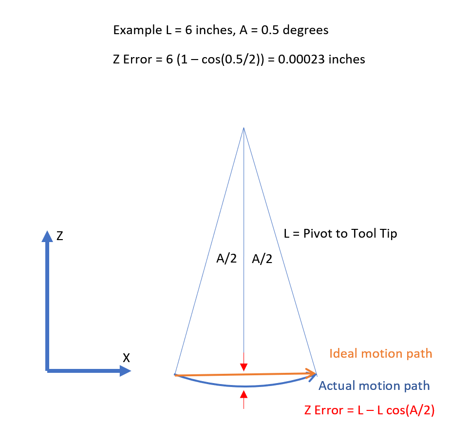

Kinematics are only performed on the endpoints of segments and a linear relationship is used as an approximation in between. Below is an example of pure angular motion with MaxAngularChange of 0.5 degrees and tool tip to gimbal pivot of 6 inches. In this example there wouldn't be any Z motion along the segment, where ideally Z should follow the curved path. The error in this case would be 0.22 milli-inches.
The trade off is between accurately following the nonlinear path and the number of motion segments generated. KFLOP can process approximately 2000 motion segments/second. So with segments of 0.5 degrees speed of rotation would be limited to about 1000 degrees/sec.
