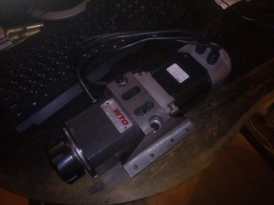

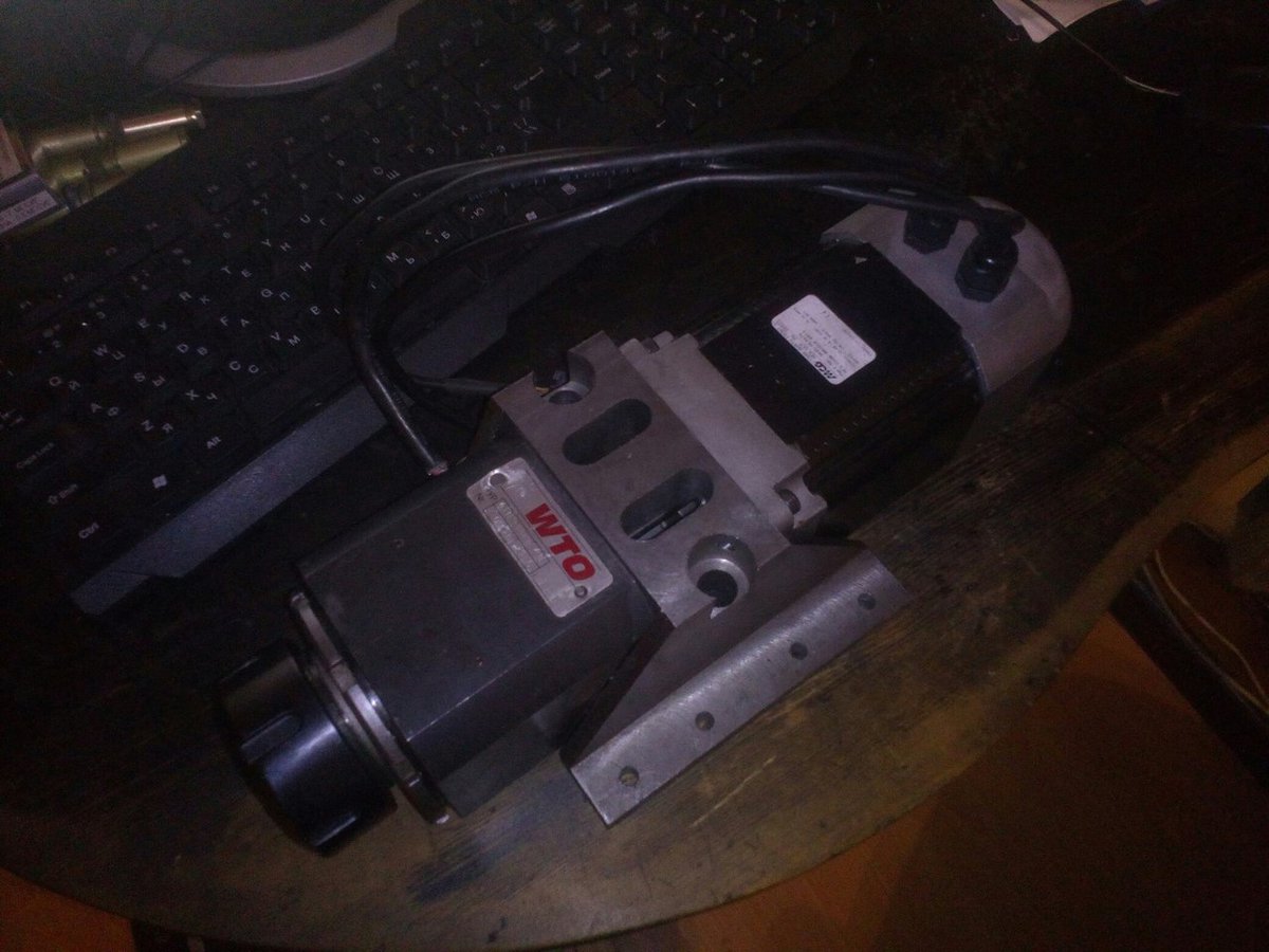

Hello! I'm collecting the machine. I will connect the encoders, so I decided to buy KFLOP. The axles are controlled by step/dir. Spindle with analog control. I bought a PWM conversion board in 0-10V. (a photo). If I still understand in the electrician and can disconnect the wiring, then in programming, a full zero. I ask for help on correct adjustment of spindle control!
The maximum spindle speed is 5647 rpm.
P.S. Sorry for my English.
