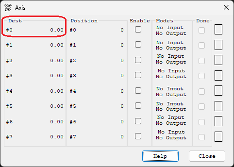

Your configuration seems to work for me. The Destinations in the KMotion | Axis Screen change. Do they for you?

Run KMotion.exe. Open the Axis Screen. When you Jog in Mach3 do the Destination values for the corresponding axis change?I'm not sure to fully understand your question "The Destinations in the KMotion | Axis Screen change. Do they for you?"
