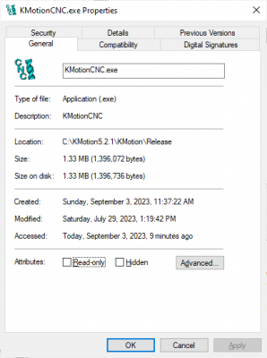

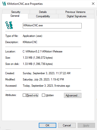

Does the Modified timestamp of KMotion\Release\KMotionCNC.exe match that shown below? If not please re-download, re-install, and try again.

I can't reproduce that. 5.2.1 hasn't been released. Maybe you downloaded an incomplete version.
Maybe something specific to the PC? Do you have a Windows 10/11 to try it on?
