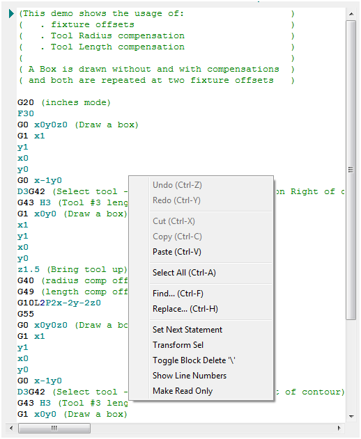

Right clicking in the GCode Editor has an option for making the Editor Read Only. However on the next start of KMotionCNC it will be Writeable again. See here.

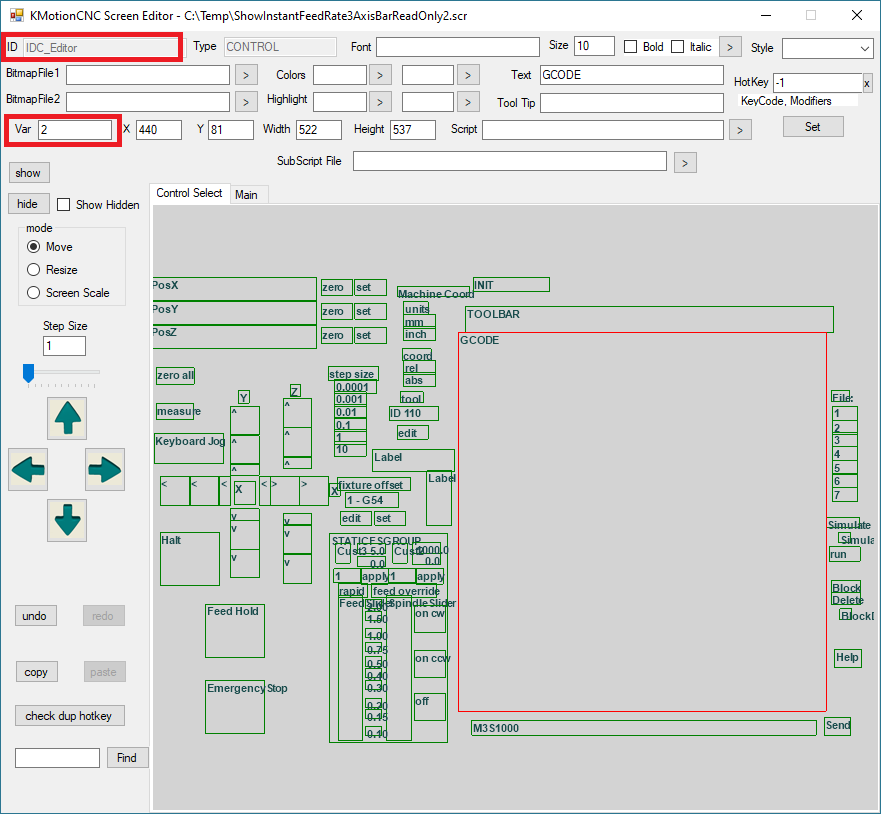

The Screen Editor can be used to set the Var parameter for the GCode Editor to either:
0 = Initially Read Only but changeable by the context menu
1 = Initially Writeable but changeable by the context menu
2 = Read Only and unchangeable
