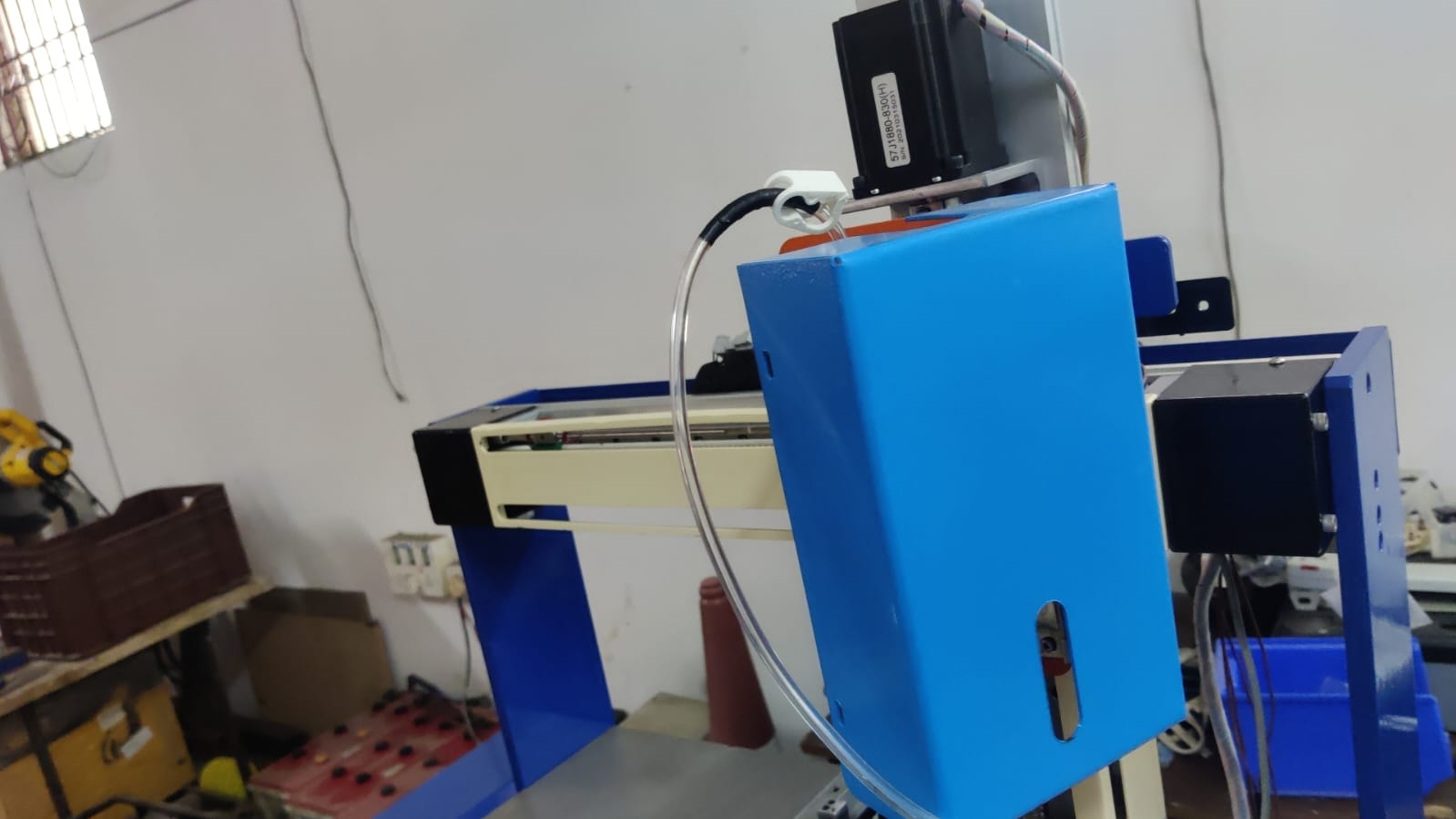

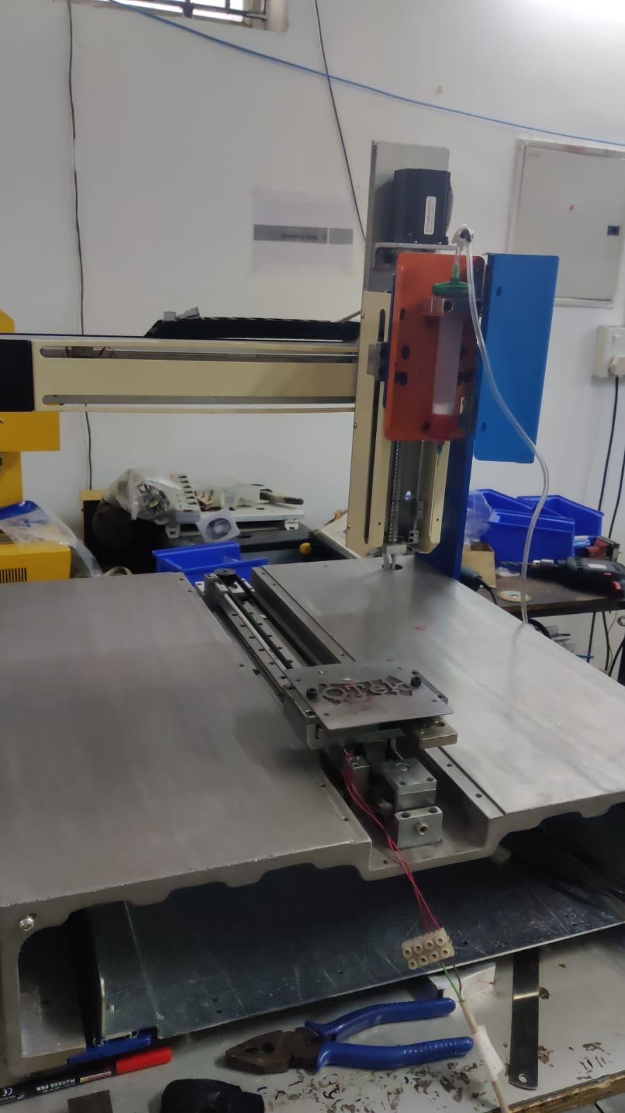

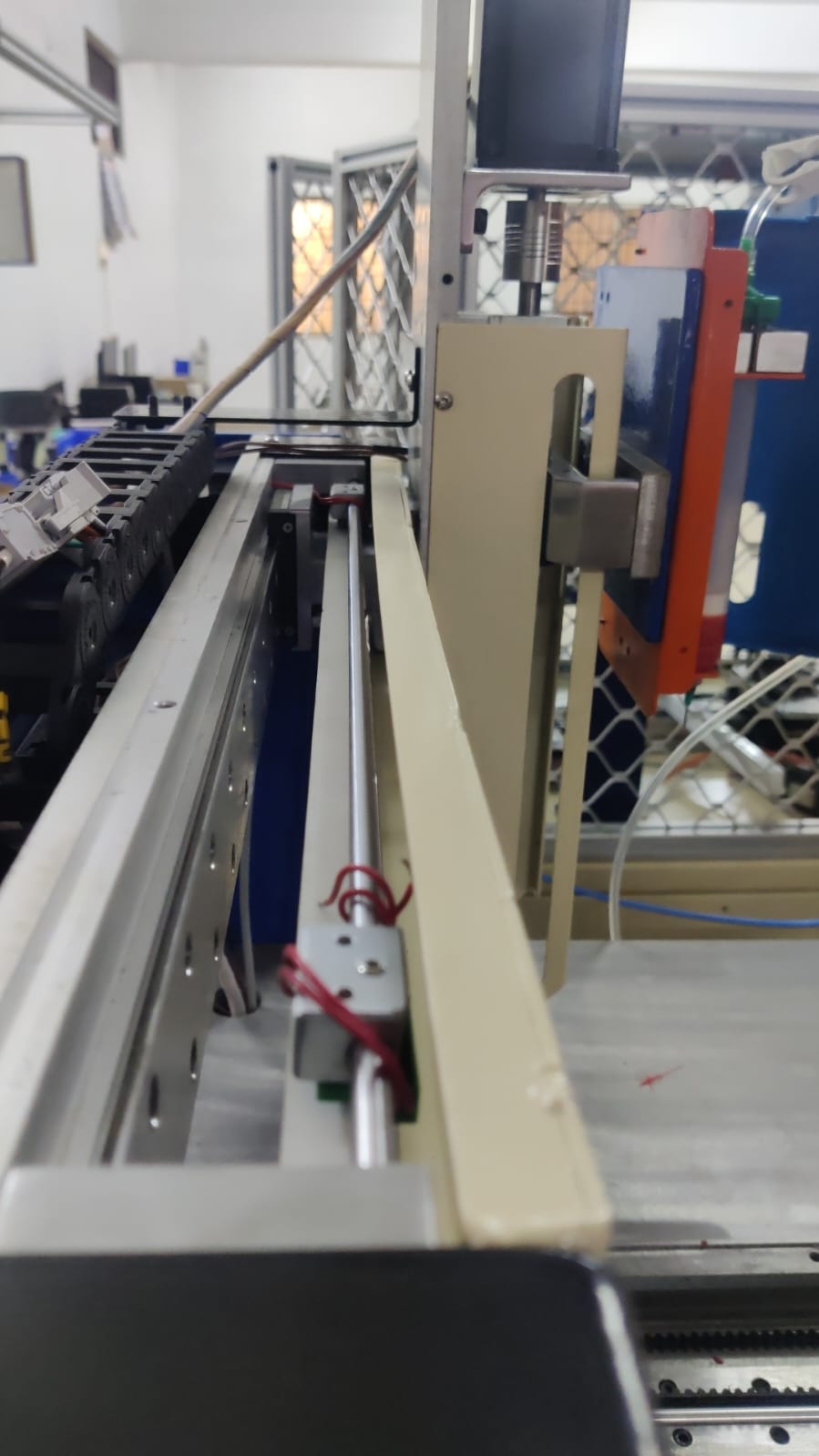

we have a glue dispensing machine controlled by Kstep. recently we changed the axis mechanical setup to timing belt rotated via pulley for axis movement.But we have been experiencing over stepping of the motor than the commanded position that is each time there is an increase in step around 1mm. The axis movement is smooth there is no jerk even though there is a positive shift in motor stopping. i have been attaching our machine image below.
There is Repeatability issues in our system.
