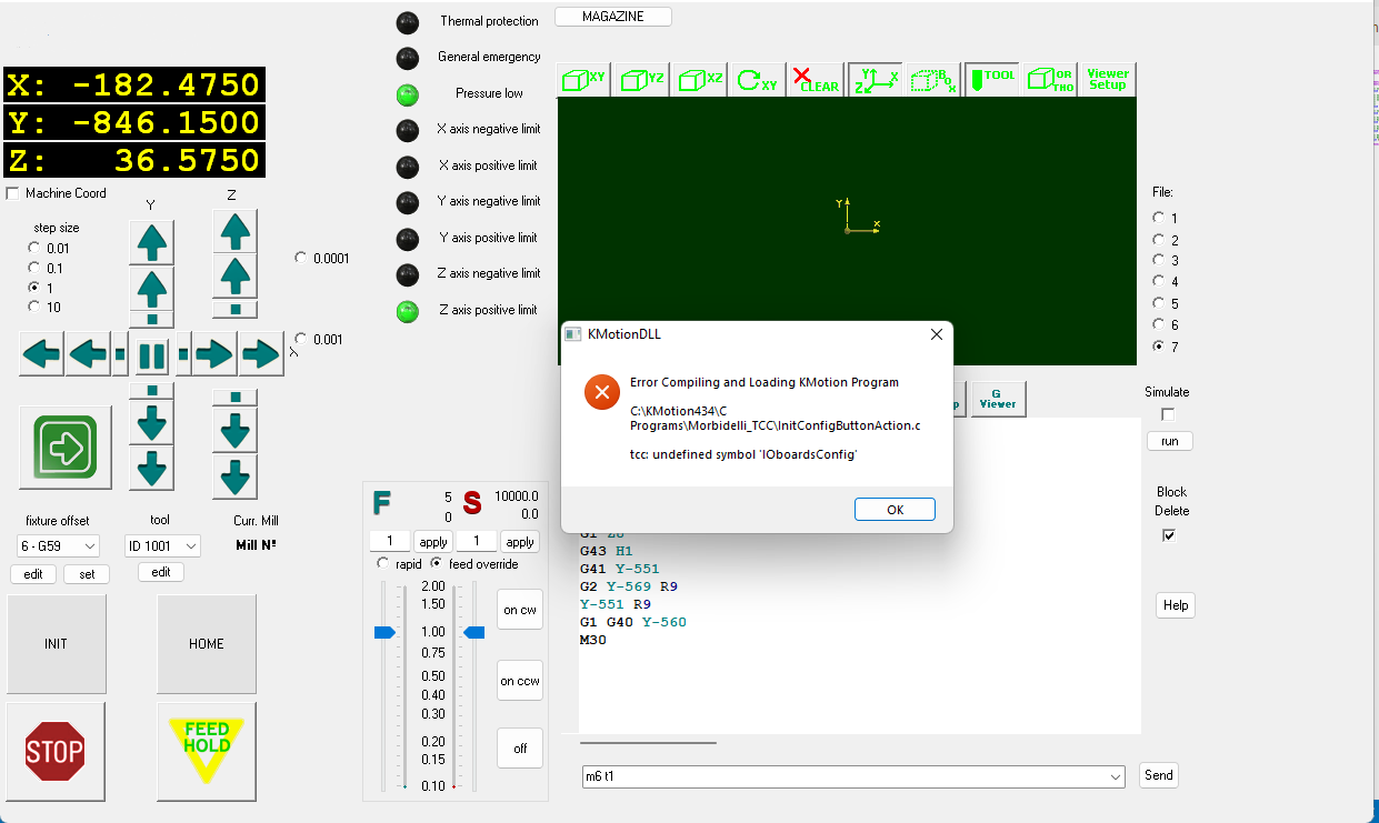

When I try to execute the Init button I get the following error:

The example in your reference compiles 2 files separately and then links the 2 files together.
KMotion is set up to simply compile one file and link it. So you must also include InitConfig.c in InitConfigButtonAction.c to form one .c file with everything.
