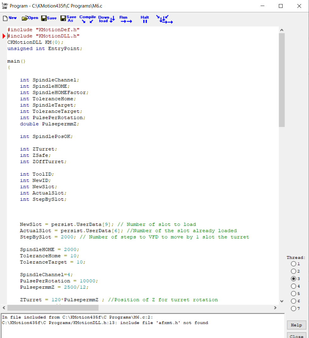

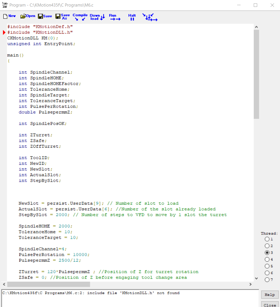

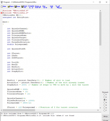

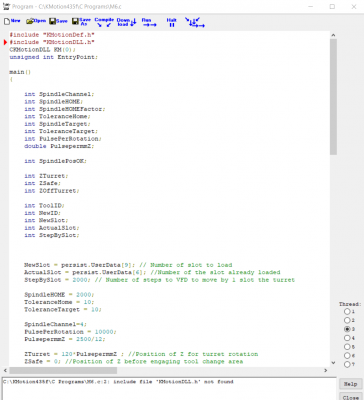

I have been trying to call a program in a program, from some examples I see I need to include "KMotionDLL.h" the but I always get a message error :
If I copy the file in the folder then I get that :
I must be missing something...

KMotionDLL.h is for a C++ Class for code that runs on the PC under Microsoft Windows. It can not be used in a C Program that runs on KFLOP.
Could you describe more specifically what you are trying to do?
