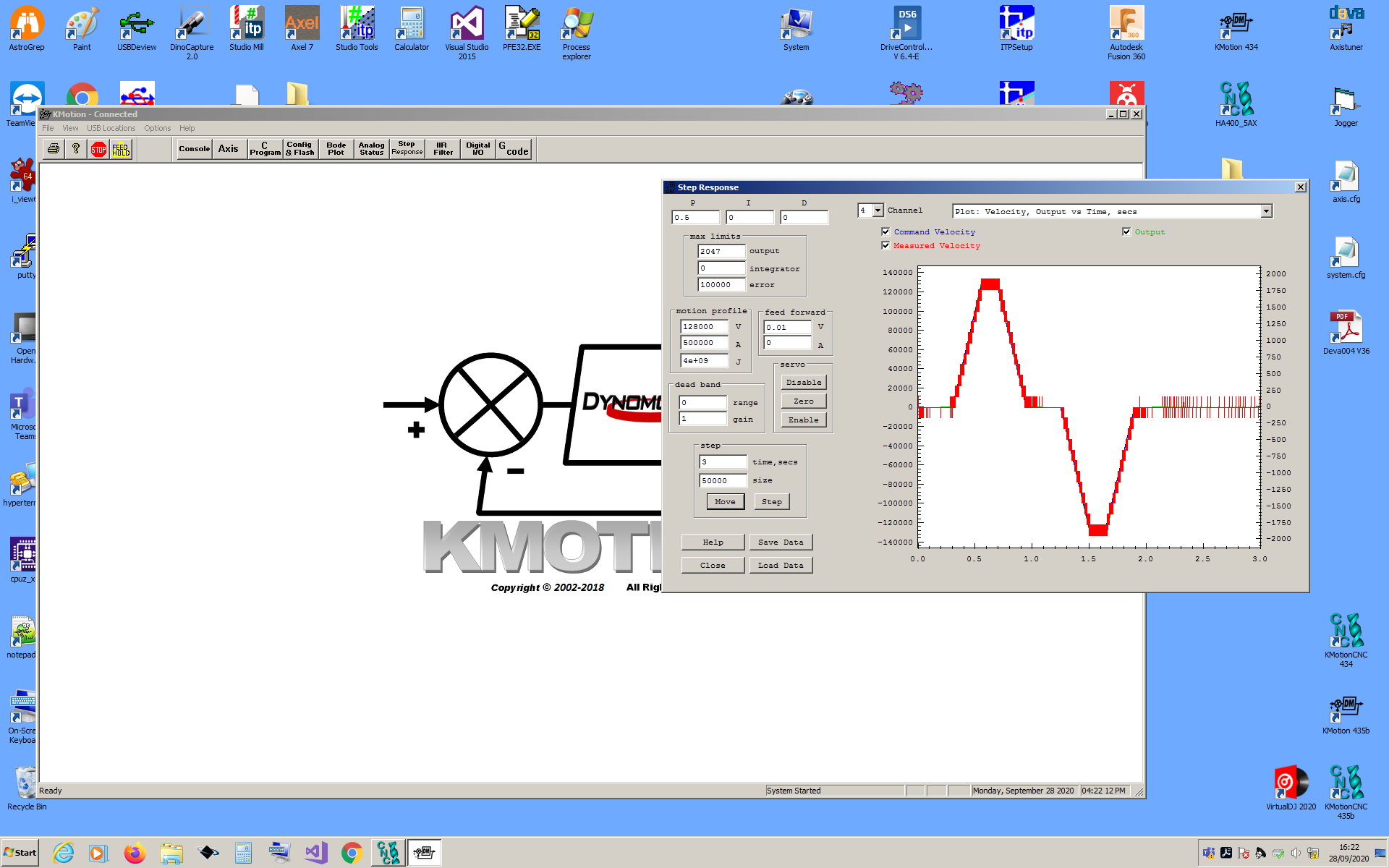

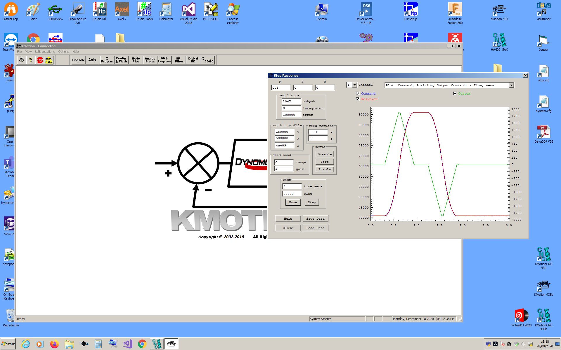

Chevvron
Posts: 24
Joined: Mon Apr 22, 2019 9:26 pm
Re: 4.35d, Index ip, RTCP advice
Post by Chevvron » Mon Sep 28, 2020 5:08 pm
Tom,
I have only just got to use the machine late this evening.
I was worried about your comment of not using high enough velocities to test the machine.
I have attached motion plots for your comments please.
Tim
Posts: 2679
Post by TomKerekes » Mon Sep 28, 2020 5:41 pm
Hi Tim,
Those moves are just long enough to get up to maximum speed.
What is the resolution of your system in counts/inch or Counts/degree?
Note you can copy a single window vs the whole desktop with Alt-PrintScreen.
Plot Error to see the Following Error more clearly.
Chevvron
Posts: 24
Post by Chevvron » Mon Sep 28, 2020 7:21 pm
Tom,
The information below is from memory as I am now at home.
The input gain in the init file is scaled so that the resolution is 1 micron.
The linear axis feedback is the emulated quadrature output from the Stober direct drive lead screw drives.
The rotary angular axis drives are harmonic drive actuators scaled such that 2275 counts = 1 degree.
I will resend the motion plots as single screens tomorrow along with error plots.
I will also email our init file.
Tim
Posts: 2679
Post by TomKerekes » Mon Sep 28, 2020 8:31 pm
Hi Tim,
In that case it seems you are testing at the Trajectory Planner setting's Velocities and higher than the Trajectory Planner Accelerations so its not clear why you need to reduce the settings.
If you send me all your settings, init file, and a GCode fragment that fails I can try to see if I can figure it out.
