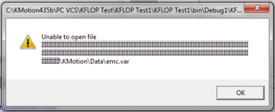

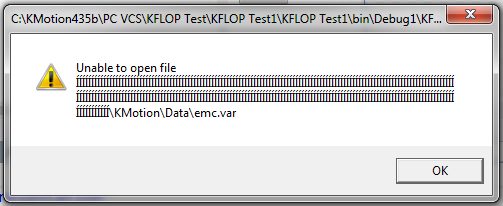

My biggest problem right now is that when I try to execute a Gcode program I get a message box that says "unable to open file ..... \KMotion
\Data\emc.var
The code I tried to use for opening the Gcode and starting it looks like this:

KM.CoordMotion.Interpreter.InitializeInterpreter(); <---- I'm fairly certain that this is the call that is failing

Hi Dan,
The KMotion Libraries expect a certain directory structure to be able to find all the executables, libraries, and data files. If you target your executable to be placed into C:\KMotion435b\KMotion\Debug like all our examples then things should work without problems.
Otherwise the Interpreter requires a "var" file to load/save its GCode Variables. A default file called emc.var is located in the C:\KMotion435b\KMotion\Data directory. You can create your own "var" file, place it wherever you want, and tell the Interpreter its name and path using the VarsFile Property.
