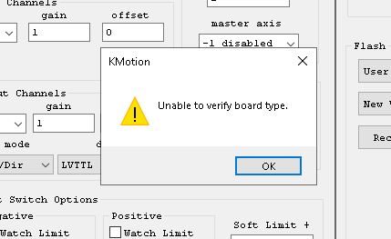

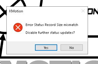

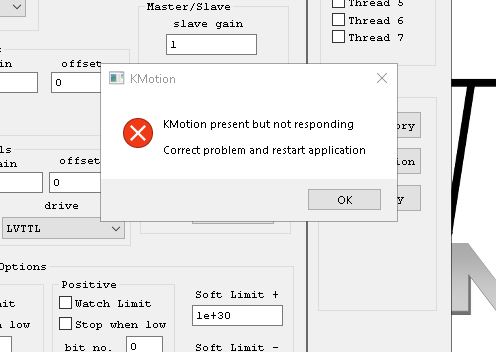

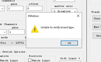

i thought it might be nice to run the newest version
deleted old and downloaded new
now i get
Re: simple 2 axis lathe initial lathe set up
Post by TomKerekes » Wed Dec 13, 2023 12:06 am
That seems to be a problem that was introduced recently when going from an old Firmware Version to new. We are working to correct it.
You should be able to use Flash Recovery as a workaround.

it almost works but then locks up windows and closes
Post by TomKerekes » Wed Dec 13, 2023 12:32 am
Another option is to use the old Version to Flash the new Version:
1 - turn off KFLOP
2 - Exit any KMotion.exe
3 - run C:\KMotion435h\KMotion\Release\KMotion.exe
4 - turn on KFLOP
5 - Flash New Version and select C:\KMotion5.3.1\DSP_KFLOP\DSPKFLOP.out
6 - turn off KFLOP
7 - Exit KMotion.exe
8 - Run C:\KMotion5.3.1\KMotion\Release\KMotion.exe
9 - Turn on KFLOP
turbothis
Posts: 331
Location: southern oregon
Post by turbothis » Wed Dec 13, 2023 1:09 am
ok, looks to back up with the newest
thanks!

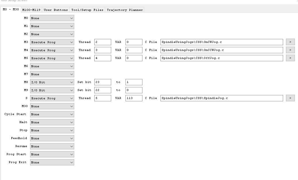

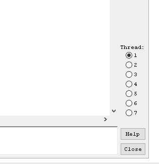

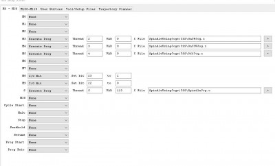

so with a fresh newest copy
i got my main init servo code as thread 1 var 0 in both C codes and user buttons
X axis moves as it should
spindle is now functioning and is tuning nicely!
1 the "execute prog" thread number must match the C code thread number for that particular code yes?
2 i seem to remember my old mill would have a green light on the thread # ( init code )for that machine while running it?
3 i see VAR 113 for the rpm speed in several places but nothing for any other VAR. i dont understand anything about this
4 DAC outputs in the console run the servo fine

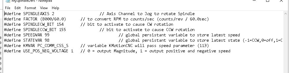

got my defs accurate and saved.....
Post by TomKerekes » Wed Dec 13, 2023 6:16 pm
No. The Button action can use whatever Thread in KFLOP you specify. It has nothing to do with what programs are in KMotion.exe screens.
If your Init program doesn't need to keep running to control/monitor anything then it can just terminate after configuring KFLOP. So if it terminates it will not be shown as still running.
For G97 Constant Surface Speed to work KMotionCNC needs to pass info to KFLOP using a few variables. See below taken from PC-DSP.h
// Persist Variable used with CSS Constant Surface speed for Spindle
// These parameters will be set when GCode switches to G97 CSS mode
// A User program in KFLOP must be running to monitor the mode an x position
// and alter the spindle RPM appropriately.
#define PC_COMM_CSS_MODE 110		// Mode 1=Normal RPM mode. 2=CSS
#define PC_COMM_CSS_X_OFFSET 111	// X axis counts for Radius zero
#define PC_COMM_CSS_X_FACTOR 112	// X axis factor to convert counts to inches
#define PC_COMM_CSS_S 113			// S speed setting in inches/sec
#define PC_COMM_CSS_MAX_RPM 114		// Limit max RPM to this value as Radius approaches zero
