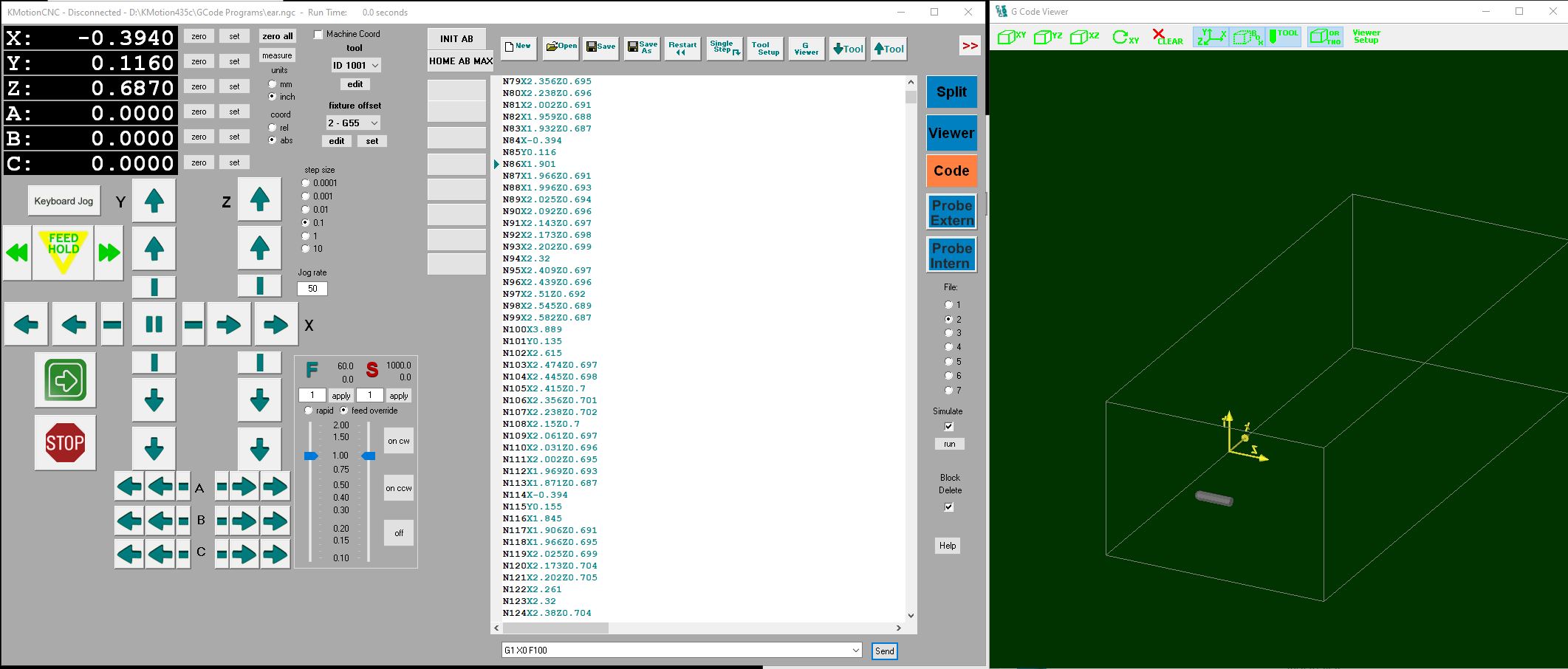

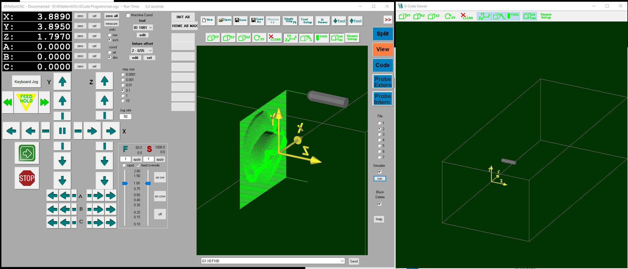

2) with the new screen set the gviewer is inside the main kmotioncnc windows (split/entire view), but I need ta view/control the toolpath gcode also in the separate gviewer windows which I can resize to full screen for better inspection, I have put the gviewer button in the screen set and I have a separate gviewer windows but the toolpath is viewable only in the main kkmotioncnc windows,
how can I view the toolpath in the separate windows as I did in the standard 6 axis screen? please see the images below
thanks
all my best

You might Execute a different(Dummy do nothing) program in the Thread. In general I try to avoid "killing" Threads whenever possible because sometimes a Thread might be in the middle of doing something and if it dies right at the wrong time it leaves things in an invalid state. So it is better to ask the Program to "please exit" say by setting a Virtual Bit. Another option might be to do the work in the Init Program's forever loop and enable/disable it with a Virtual Bit.
Sorry that isn't supported. You could make the View Screen (or another Screen) with basically only the Viewer Control so it uses most all of the screen.

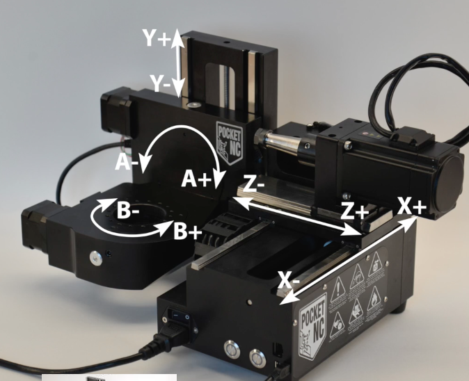

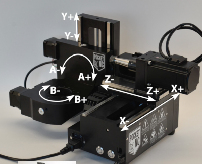

I need a confirmation about the default 4/5th axis direction "rule" in kmotioncnc viewer,
at the moment my horizontal 5 axis mill is configured such this (taken from the official pocketnc site):
this means that if the B plate rotates CCW, it goes in the + sign direction
and that if the A table rotates putting the B table vs the end mill means + sign direction
this is correct from the table point of view (where there is the work piece) according to the respective linear axis Y & X (right screw vs linear + direction)
this is also confirmed by this official online simulator: https://sim.pocketnc.com
Kmotioncnc viewer seems to consider instead the "mill" point of view also for the direction of A & B axis (which is commonly used and right for the linear axis X Y Z) and so when I simulate a 5 axis gcode the mill goes in the opposite angular directions.
Based on your great experience and know-how which is your best recommendation for the A & B rotary direction sign setup?
the piece point of view or the mill point of view? is it possible to change the rotary direction sign mill in the viewer simulation?
I am a little confused cause online you find opposite points of view....
thanks
dd

I think of it like drawing with a pen on paper. The CAD data should be what is to be drawn on the paper regardless of the machine configuration. So if the machine moves the paper instead of the pen it should move the opposite directions. Similarly with angles the CAD should specify how the tool should be oriented. If the machine rotates the part instead it should do the opposite.
So if everything in the diagram is reversed I think you end up with a proper right hand rule configuration which I would expect to match what GCode Viewer does.
Can you describe what your machine actually does?
