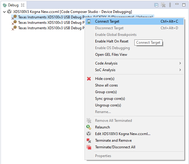

Re: Kogna debug suggestions
Is J6 the JTAG port on the Kogna? The online documentation refers to the Kflop, but the Kflop uses JP2 for JTAG. As the only 14-pin header on the board, I'm guessing it is, but would like confirmation before smoke testing.
- Posts: 2892
Hi Steve,
That is correct. Rev 1.2 Kogna changes the connector label to JP2.
Attached is the Target Configuration we use for CCS 11.
The basic process is to "launch" this target configuration.
Note the JTAG connects to the DSP and daisy chains also to the other 2 PRU processors in the chip that we do not currently use. So right click on the first processor (C674X) and Connect Target.
At this point the Disassembly Window should show where the PC is in Memory and show memory which shows it is connected and viewing into the DSP
You can then Run | Load Program | DSPKOGNA.out
You might also load User Programs or Symbols for User Programs.
If the Boot Jumper is removed then if you "Run" the code it should execute what is in memory without boot loading anything from Flash.
Apps should then be able to communicate with Kogna.

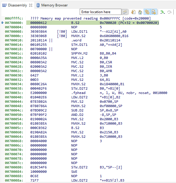

I think CCS is basically going. For anyone else out there using CCS on Linux (Ubuntu), Version 11 works on Ubuntu 22.04, but fails badly on 16.04. Version 12 doesn't properly install on 16.04 because it requires a slightly up-level libc for a logging utility. Haven't tried CCS 12 on Ubuntu 22.04. I'm using CCS 11 because that's what Tom's using.
Q. for Tom: do you know what's at address 0x00712148? It's an IDLE instruction and it seems to be stuck there. Even though I load symbols for the firmware and my code, it doesn't know that location, although it looks like legit code in the disassembler. I guess it could be my code from other threads, but it's beyond my patience and understanding to load all our code one by one to find it. But that address doesn't look like the normal thread space (?)
Background: I recompiled all our code with -g. It actually made it sometimes *not* crash, but usually crashes. Is at a different location to where it ended up without -g. In that case, it was executing in some of my data, and just happened to hit an instruction sequence which hard looped back on itself.
IER is all zero (except the NMI bit). Would that explain why the firmware doesn't get back control?

0x00700000 - 0x007FFFFF is the DSP's internal Boot ROM. If it is stuck there then the code most likely crashed and fell into the Boot ROM.do you know what's at address 0x00712148? It's an IDLE instruction and it seems to be stuck there. Even though I load symbols for the firmware and my code, it doesn't know that location, although it looks like legit code in the disassembler. I guess it could be my code from other threads, but it's beyond my patience and understanding to load all our code one by one to find it. But that address doesn't look like the normal thread space (?)
When -g debug code is enabled much of the compiler optimization is disabled. The TI Compiler is very powerful and aggressive reordering things, operations in parallel, and whatnot. So for example if a loop is waiting on a variable to be set by another Thread, and the variable is not declared volatile, then the compiler might load the variable into a register and test the register in the loop and so get stuck in the loop forever.Background: I recompiled all our code with -g. It actually made it sometimes *not* crash, but usually crashes. Is at a different location to where it ended up without -g. In that case, it was executing in some of my data, and just happened to hit an instruction sequence which hard looped back on itself.
That would be a problem. Normally bit 6 is also set to allow the 90us Timer interrupt to do servo samples and switch Threads. If that was ever turned off multi-tasking wouldn't work.IER is all zero (except the NMI bit). Would that explain why the firmware doesn't get back control?
