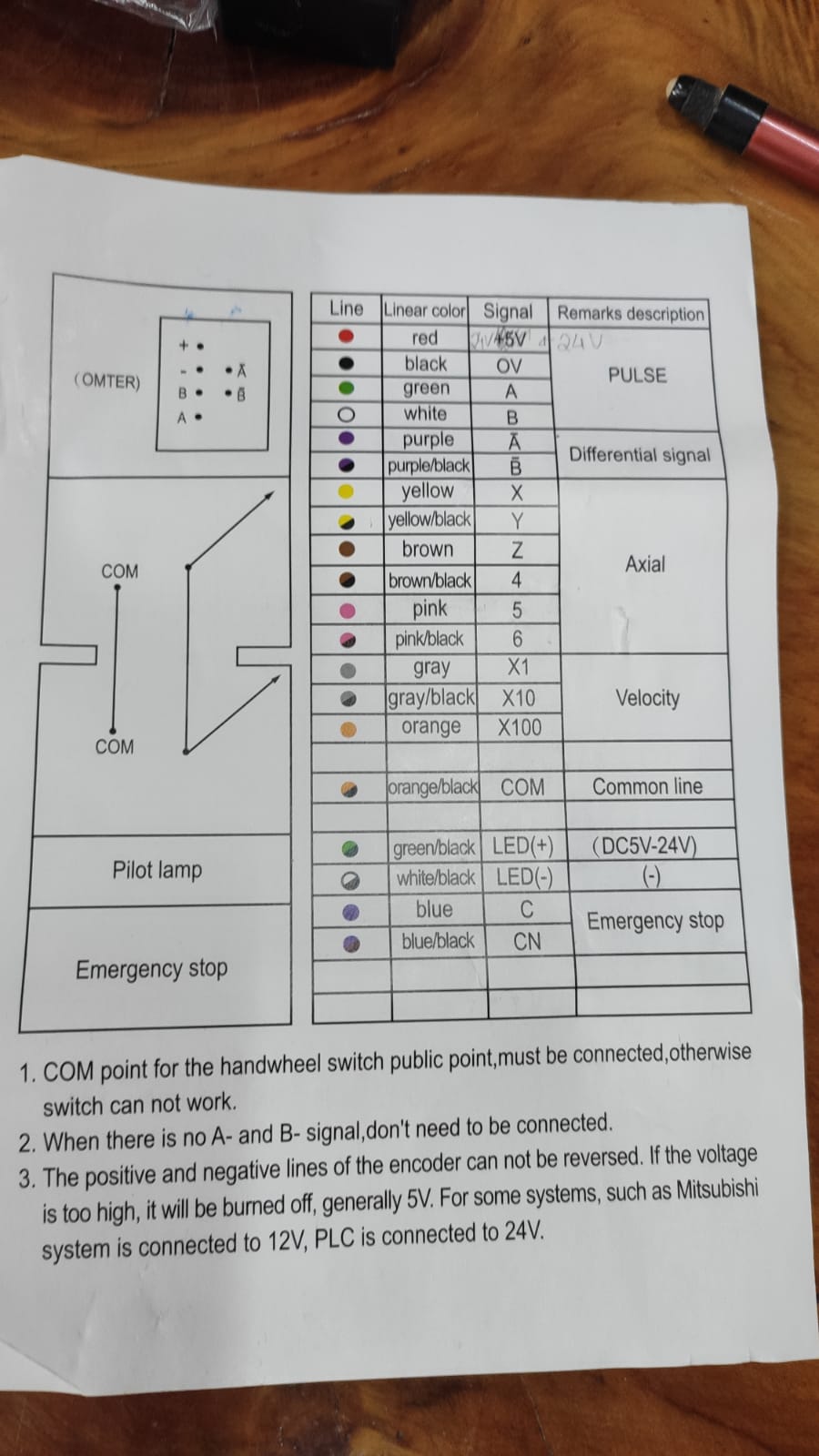

Hi Tom.
Here is the scheme for the MPG pendant.

Hi Gabriel,
That doesn't really help and seems to indicate a 5V encoder.

Hi Tom.
This is what i have from the chinese manufator. The encoder is 24v. The paper shows 5v but it's 24v.
Is there a way to test if kanalog is able to read the return of the encoder?

Hi Gabriel,
Never connect a 24V signal to Kanalog encoder inputs.
Test with an oscilloscope or voltmeter that the outputs are 5V or less before connecting.
