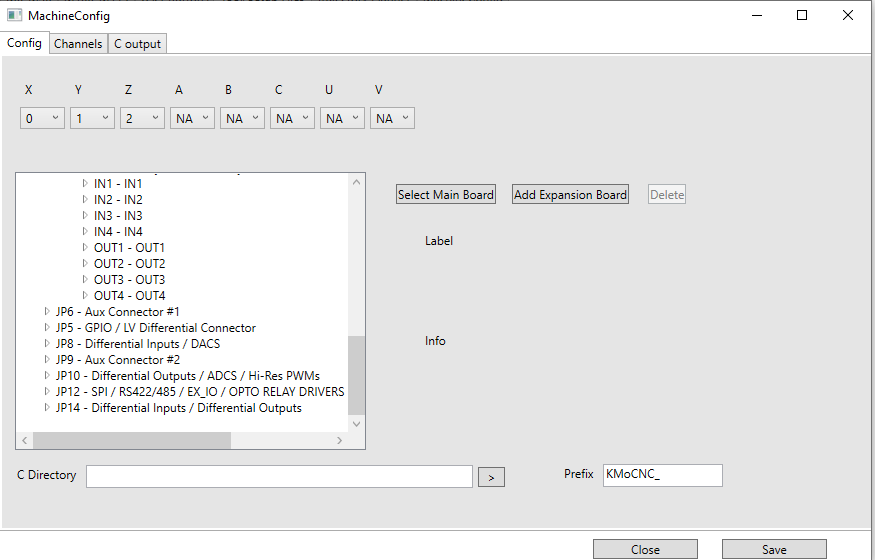

So after a bit of a hiatus from working on this, I've spent the past few weeks working on one of the things I've wanted to code for a while, the ability to create an Init file, without having to write/copy/paste/edit any C.
This code has been created using the functionality-

To use the Init builder functionality, copy the attached ZIP file contents to the Release directory of your KMotion install (currently C:\KMotion5.3.6\KMotion\Release), and run KMoCNC.
You'll be greeted by a popup saying "Failed to open Config File", click OK and the default will be created, and then the garish default screen should appear (the default screen is hardcoded, and is on my todo list to make less garish, now I know that functionality works!).
Click the Config Tab at the top, then on the Machine Config row, click New to create a new Machine Config profile.
Then click Edit, which will open the MachineConfig window.
At the moment, all you need to do is set the channels on the Config tab, along with the C directory (you don't have to set the directory, if you don't want any files written).
Then on the Channels tab, configure each channel (The limit switch functionality hasn't been added yet), which is a similar layout to KMotion, with the exception of the Enable drop down menu in the top right. For those familiar with KMotion, the options should be apparent.
Then finally, on the C Output tab, click the Generate Init buttong. This will create the C code in the window, and if the C directory has been set on the Config tab, create an init.c file in that directory.
As for the other functionality, on the Config tab, you can select your mainboard, and add Expansion boards (only Kanalog and Konnect have been added so far). This will then create a TreeView off all connectors, with details of every pin.
The next step is to have any Expansion boards added to the init.c, so you can create a basic init file to customise.

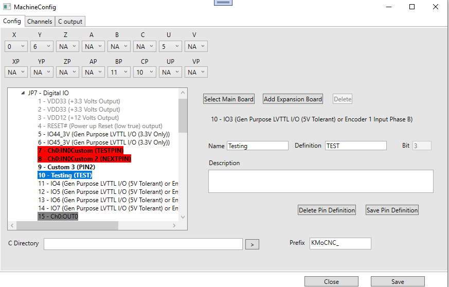

So I've been working on this whenever I get some time, and have now added the next few bits of functionality, and fixed a significant bug in the previous version.
+ Any pins used by channels, are now highlighted with a grey background in the Tree View.
+ You can now add a description, and if needed, a Definition to each pin, along with a description.
Any definitions added, will be added to the init.c
Description is purely for your own reference purposes.
+ Should a pin be used by a channel, and you also set a custom name/definition for it, it will be highlighted in red.
+ Any Konnect boards added, will now add the relevant code to the init.C to enable them.
And the big bug fix was on the channel configuration page.
I had wrongly coded it so the channel output options were configured based on the channel number, and not the output channel number.

This update is mostly Machine Config GUI tweaks so things re-size far more gracefully, such as the connector TreeView expands, and all the related controls move.
Limit Switch functionality has now been added.
