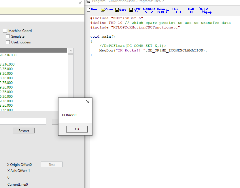

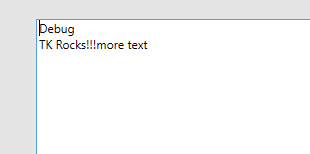

Using the same KFlop C code as my previous post, to just generate a basic messagebox with just an OK button, I get this in my debug text output-
However although I can select the text, and copy it, whatever I paste it into, only pastes the TK Rocks!!! part. I've even tried generating more lines in my textbox, and removing the !!! but any text after the string read from the KFlop, doesn't get pasted. I suspect whatever is causing this, is also causing the lack of text to be added to the message box.
To me it's like there is some kind of magic charachter being added to the KFlop string that blocks all text after it, and I'm not even sure what to google for to even start looking for a solution :?:
Any ideas?

Post by TomKerekes » Thu Dec 31, 2020 12:59 am
Hi Moray,
Oops I mistakenly added the zero terminator to the string. I'm not sure exactly how C# strings work internally but the null isn't needed it already is a terminated string. Change:
                    msg += Convert.ToChar(val);  // add to string
to
                    if (val != 0) msg += Convert.ToChar(val);  // if not the null terminator add to string
Moray
Posts: 307
Post by Moray » Thu Dec 31, 2020 6:14 pm
Thanks Tom, that has fixed the problem.

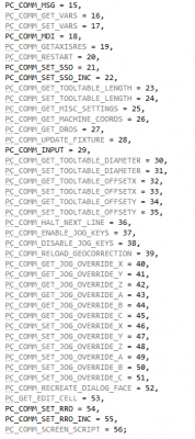

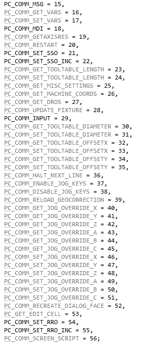

Anyway, Input Boxes now work, and I've just ticked PC_COMM_MDI off the list, which I think means most of the more complicated PC_COMM commands have now been ticked off the list. At least the ones I need to implement -
Once I get the tool offset handling sorted, I might even get back to working on my touch probe routines :-)
