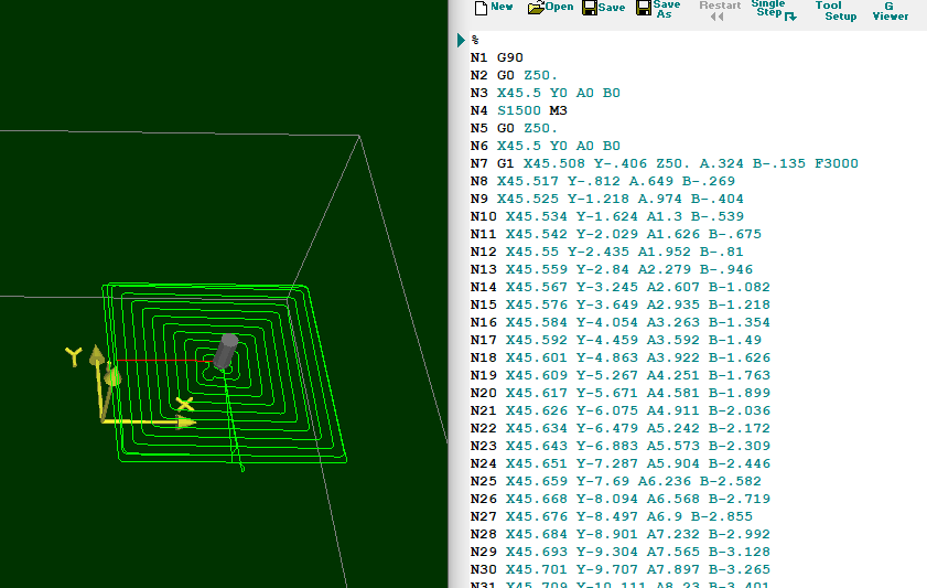

I made changes to the postprocessor for the PowerMill program, the code looks like this
. This will work fully when creating a standard profile setup? when simulating in KMotionsCNC - the trajectory is displayed correctly
N1 G90
N2 G0 Z50.
N3 X45.5 Y0 A0 B0
N4 S1500 M3
N5 G0 Z50.
N6 X45.5 Y0 A0 B0
N7 G1 X45.508 Y-.406 Z50. A.324 B-.135 F3000
N8 X45.517 Y-.812 A.649 B-.269
N9 X45.525 Y-1.218 A.974 B-.404
N10 X45.534 Y-1.624 A1.3 B-.539
N11 X45.542 Y-2.029 A1.626 B-.675
N12 X45.55 Y-2.435 A1.952 B-.81
N13 X45.559 Y-2.84 A2.279 B-.946
N14 X45.567 Y-3.245 A2.607 B-1.082
N15 X45.576 Y-3.649 A2.935 B-1.218
N16 X45.584 Y-4.054 A3.263 B-1.354
N17 X45.592 Y-4.459 A3.592 B-1.49
N18 X45.601 Y-4.863 A3.922 B-1.626
N19 X45.609 Y-5.267 A4.251 B-1.763
N20 X45.617 Y-5.671 A4.581 B-1.899
N21 X45.626 Y-6.075 A4.911 B-2.036
N22 X45.634 Y-6.479 A5.242 B-2.172
N23 X45.643 Y-6.883 A5.573 B-2.309
N24 X45.651 Y-7.287 A5.904 B-2.446
N25 X45.659 Y-7.69 A6.236 B-2.582
N26 X45.668 Y-8.094 A6.568 B-2.719
N27 X45.676 Y-8.497 A6.9 B-2.855
N28 X45.684 Y-8.901 A7.232 B-2.992

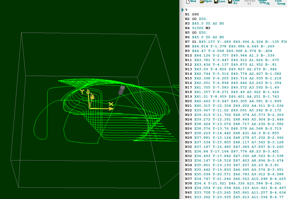

This trajectory without Activatsii RTCP - PowerMill postprocessor has a non-coretic appearance
N1 G90
N2 G0 Z50.
N3 X45.5 Y0 A0 B0
N4 S1500 M3
N5 G0 Z50.
N6 X45.5 Y0 A0 B0
N7 G1 X45.157 Y-.689 Z49.996 A.324 B-.135 F3000
N8 X44.814 Y-1.378 Z49.986 A.649 B-.269
N9 X44.47 Y-2.068 Z49.968 A.974 B-.404
N10 X44.126 Y-2.757 Z49.944 A1.3 B-.539
N11 X43.781 Y-3.447 Z49.912 A1.626 B-.675
N12 X43.436 Y-4.137 Z49.873 A1.952 B-.81
N13 X43.09 Y-4.826 Z49.827 A2.279 B-.946

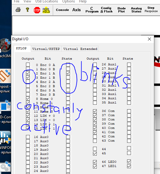

I also have another problem when turning on flashing these pinas, and in some I can 't change the value, what is the problem, the controller is not correct?

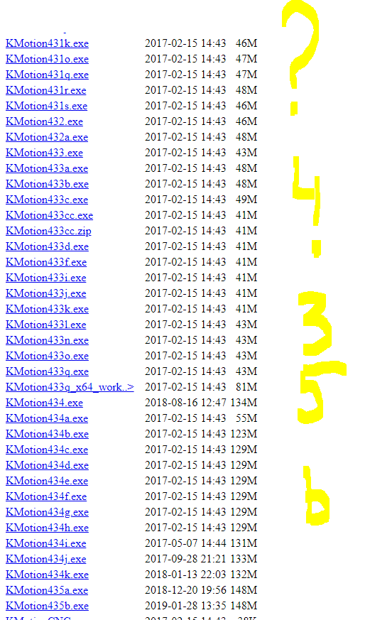

It should actually be KMotionCNC 4.35b not KMotion 435b/
But I assume that was just a typo.

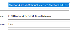

I asked previously if the size of the download was correct and I didn't see an answer. Please post the properties of the downloaded file for us to check.
You might try a fresh install of KMotionCNC 4.35b to another computer, copy in the patch, and test to see if that works.

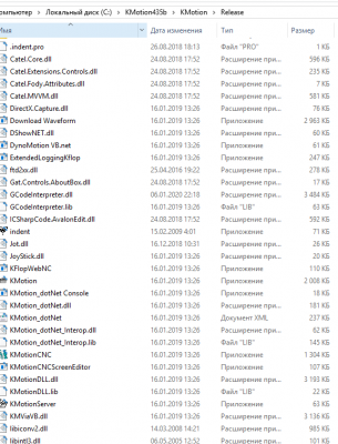

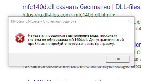

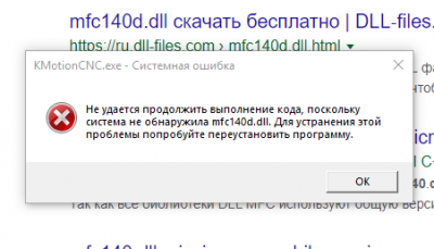

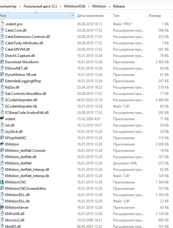

Okay, I 'll try another version now. (((( downloaded established. As soon as I add the GCodeInterpreter .dll file - the program closes at startup "
(3.4 MiB) Downloaded 450 times

Posts: 2916
Re: RTCP 5 axis machine
Post by TomKerekes » Sat Jan 11, 2020 4:37 pm
Hi Igor,
Somehow you put a space in the filename. It should be "GCodeInterpreter.dll" not "GCodeInterpreter .dll"
I downloaded your attached GCodeInterpreter .dll took out the space and it worked for me.

Post by Igor » Sat Jan 11, 2020 5:04 pm
does not work.that 's the problem?
