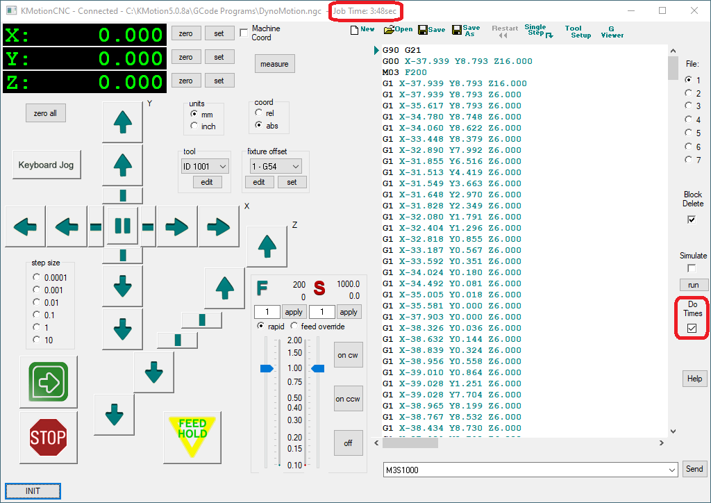

Here is a Test Version with a ‘Do Times” Simulation option added. When checked, running Simulation will fully Trajectory Plan all Paths the same as a real run (without commanding any motion) and display estimated Job Time. Displayed times have been changed from seconds to hours:minutes:seconds. GViewer Plot will then show Trajectory Planned paths rather than what raw GCode specifies.
Simulation with 'Do Times' on is a few times slower than with it off but still very fast.
Test Version 5.0.8a
You could help a lot by testing it thoroughly.
Here is shown the new option and the result

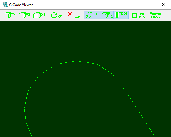

Here is the GViewer zoomed in on some GCode with faceted curves (from Dynomotion.ngc top of 'Y') plotted with 'Do Times' off. Note the facets are visible when the raw GCode is plotted.

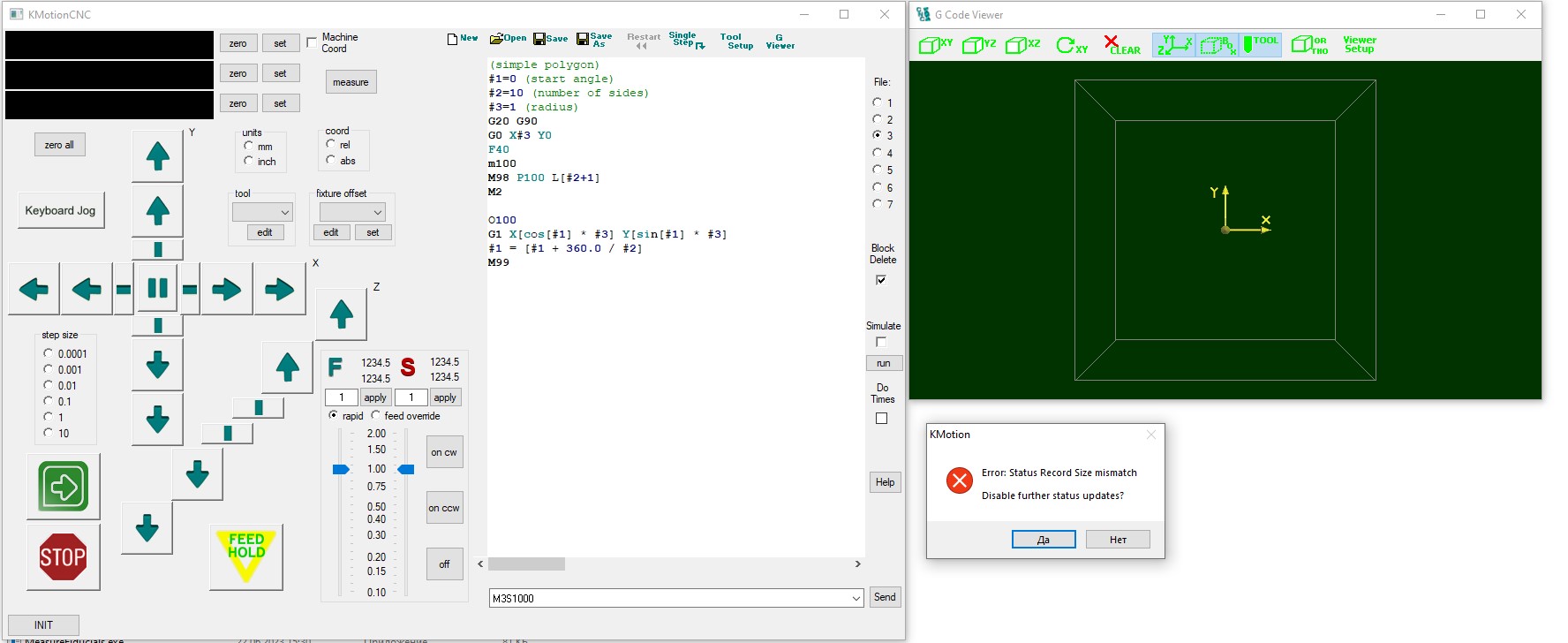

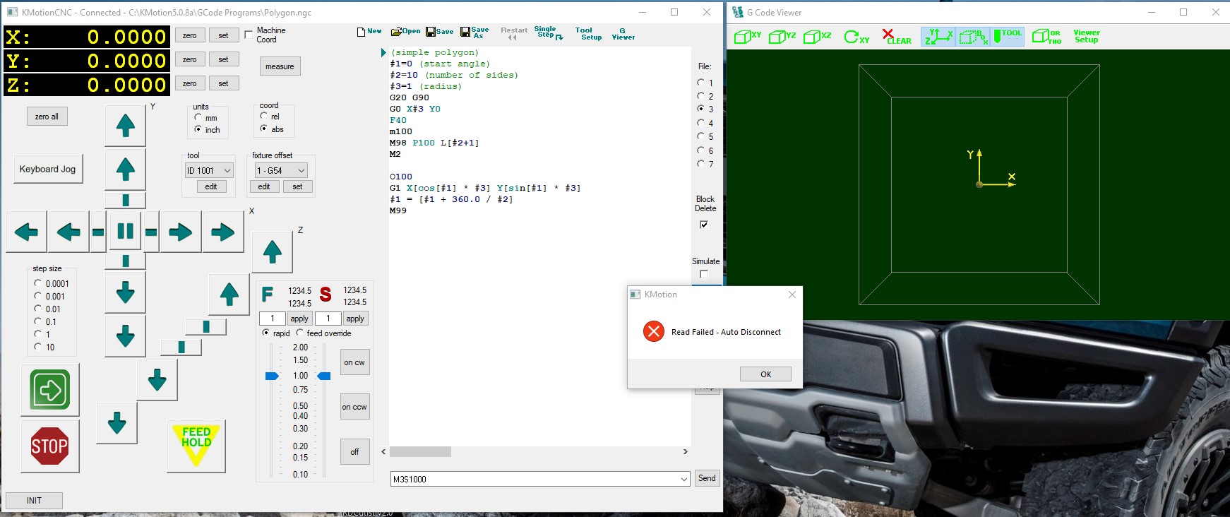

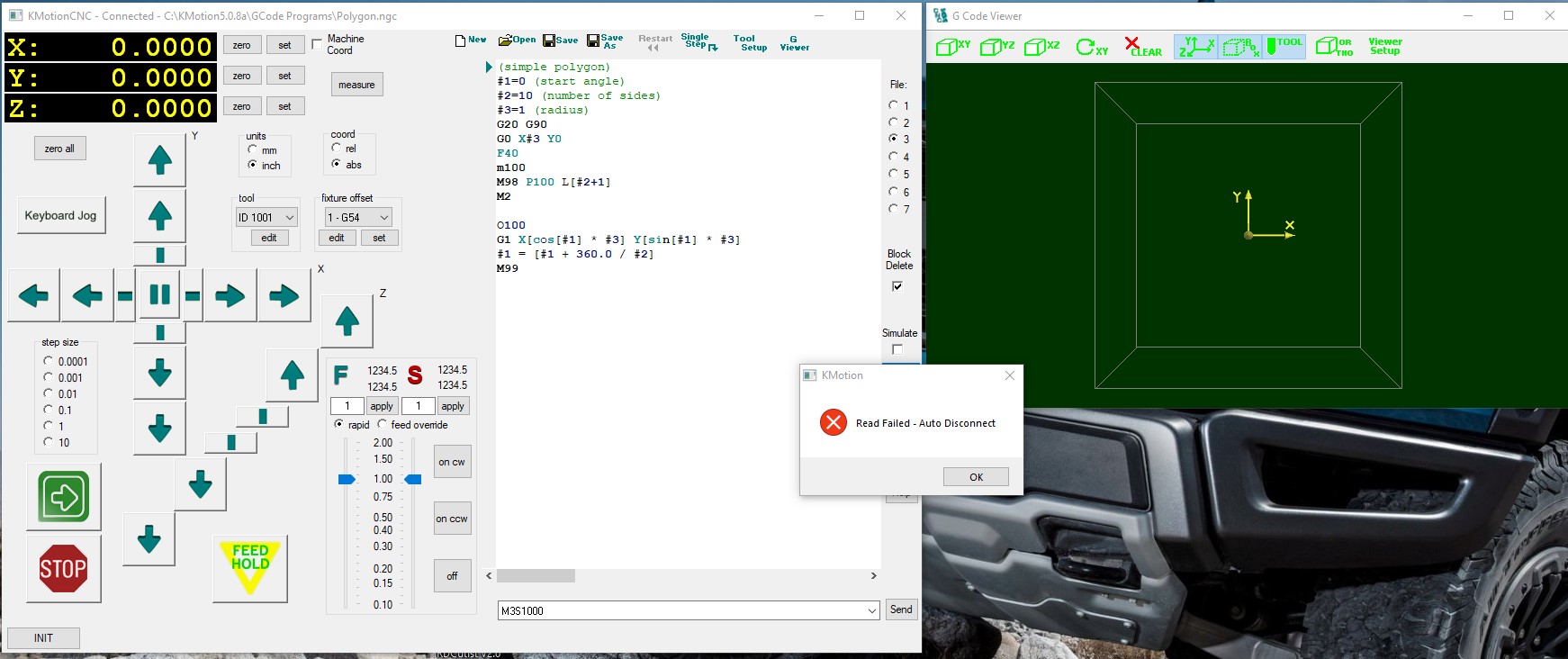

These errors with connected Kflop
Status Record Size mismatch
Disable further status updates ?
and
Read Failed - Auto Disconnect
Do I need to update Kflop?

I reshuffled the K Flop, everything was fine.
Timer in simulation mode shows 0 seconds.
In non-simulation mode, the timer works

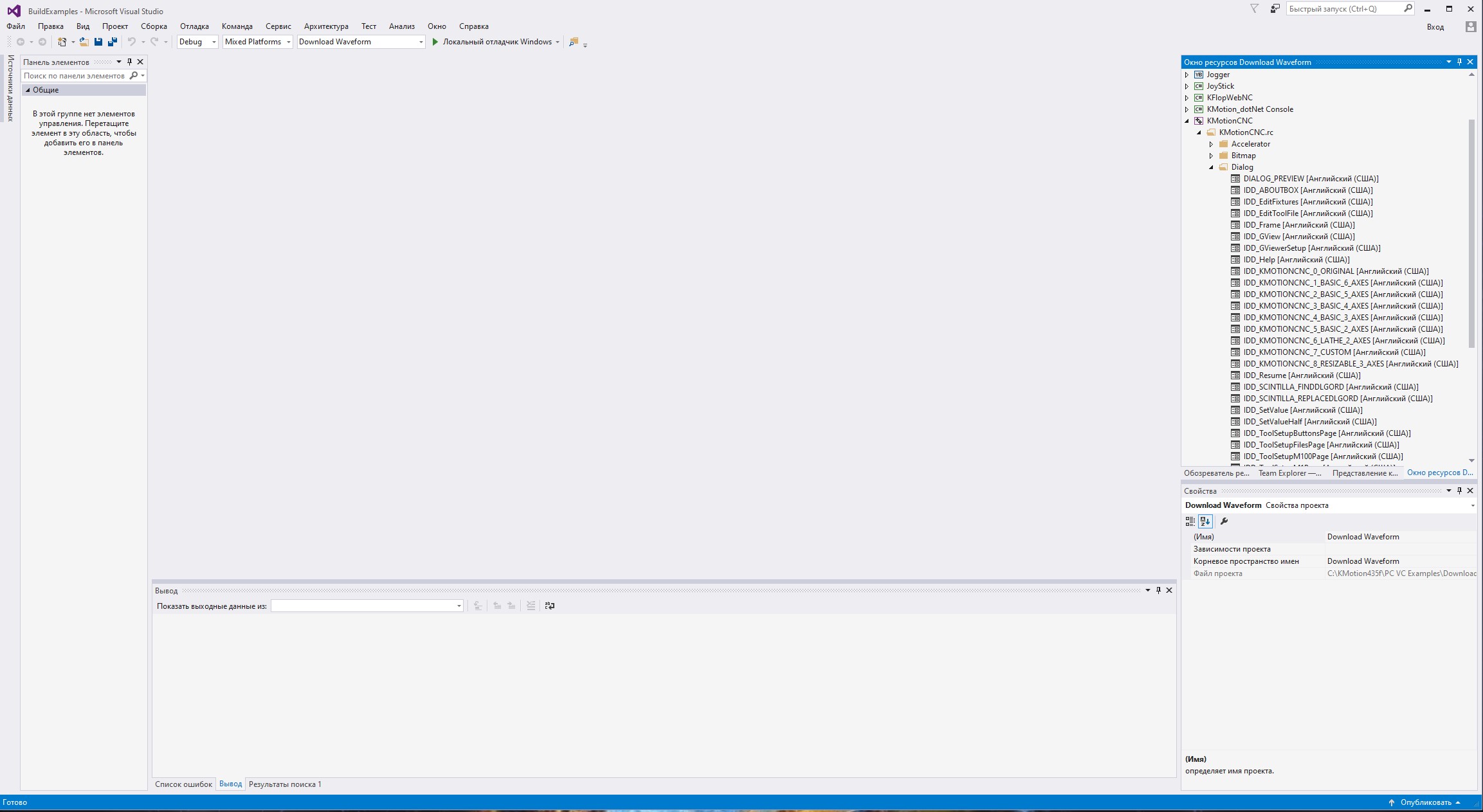

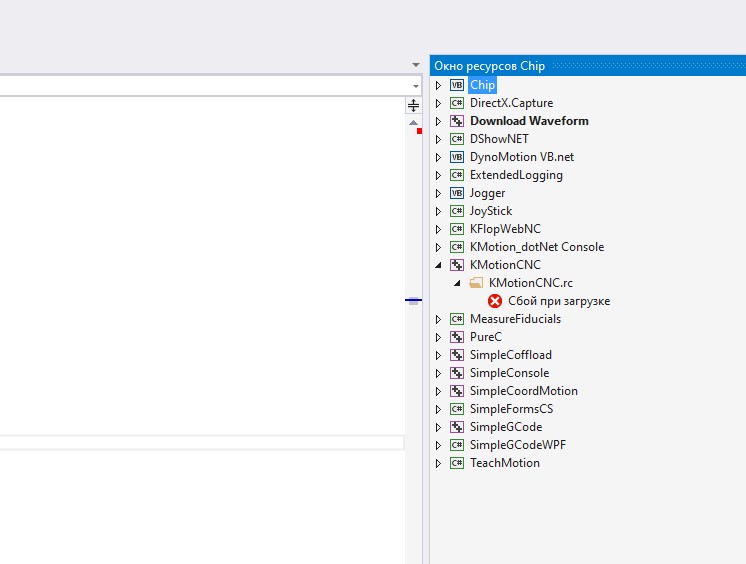

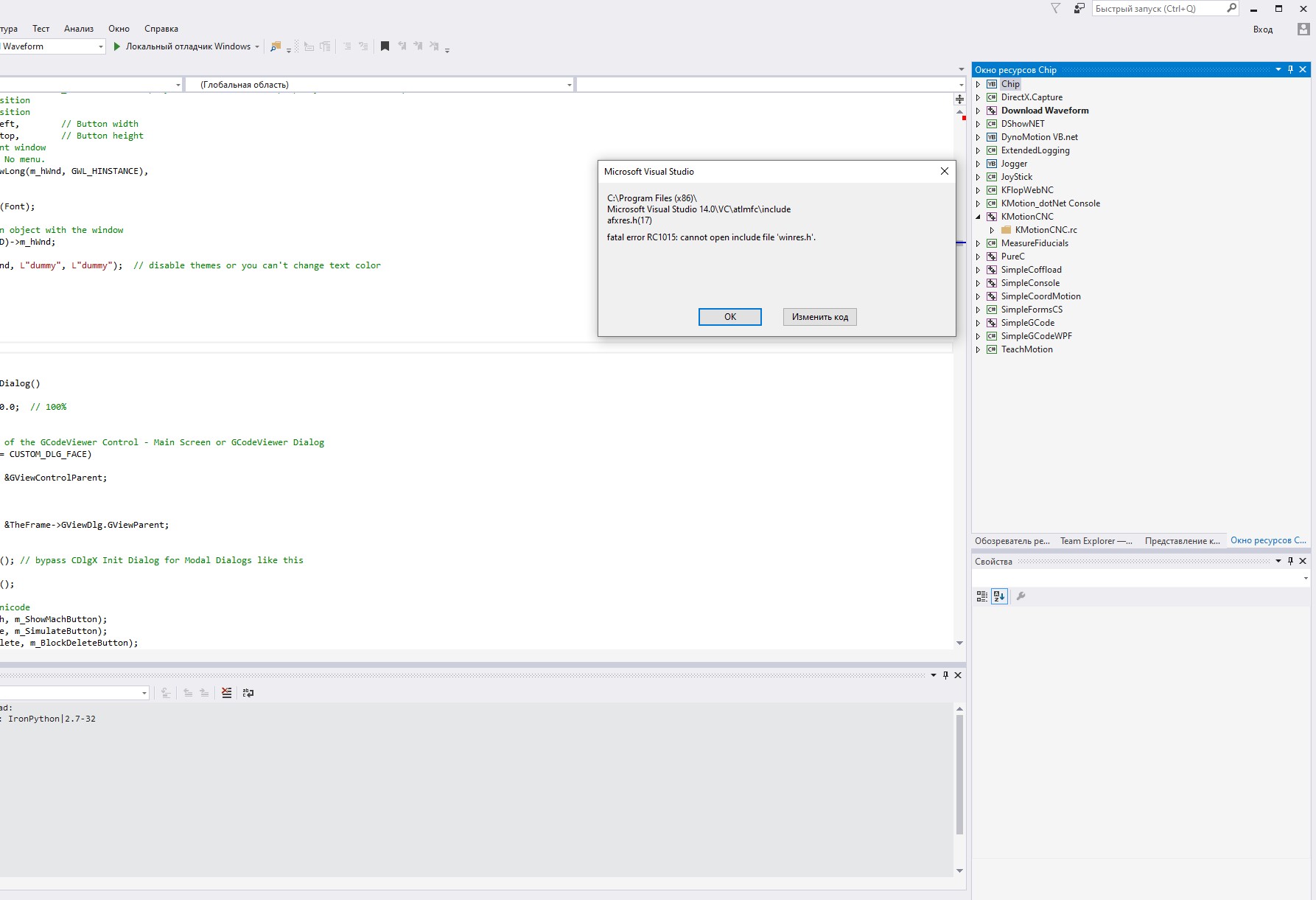

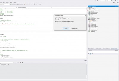

I have a bug in visual studio.
What is my problem ?
Taras.

Regarding Visual Studio I think you may not have installed MFC (Microsoft Foundation Classes).

MFС class installed and KMotion 435f version build well
This problem is only in version KMotion5.0.8a

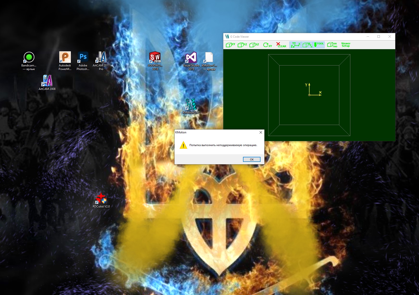

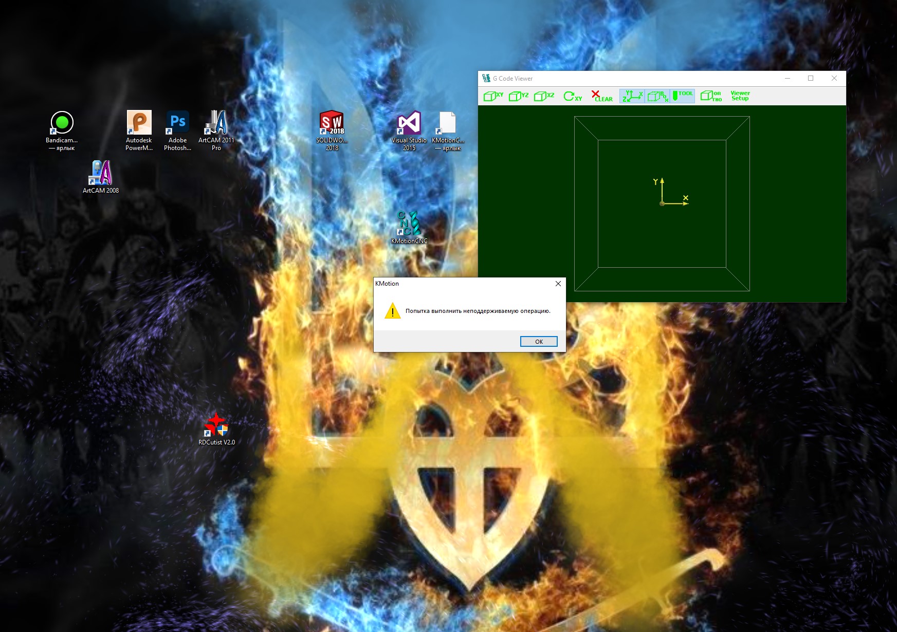

There was another problem.
When you select a 4-axis screen, the program crashes with an error and no longer starts.
It turns out that the timer only works in a 3-axis machine, but I need 4 axes.
What can you do about it Tom?
p.c. Error means - Attempted to perform an unsupported operation
Taras.
Oops forgot to include the Do Times controls in the other standard screens. Those should now work in this version.
Version 5.0.8c

Regarding the error in the visual studio window.
I have a version of visual studio 2015 and maybe you compiled in a newer version?
Or maybe you have updated some components ?
I would like to work with the appearance and not everything can be done through the Screen Editor.
