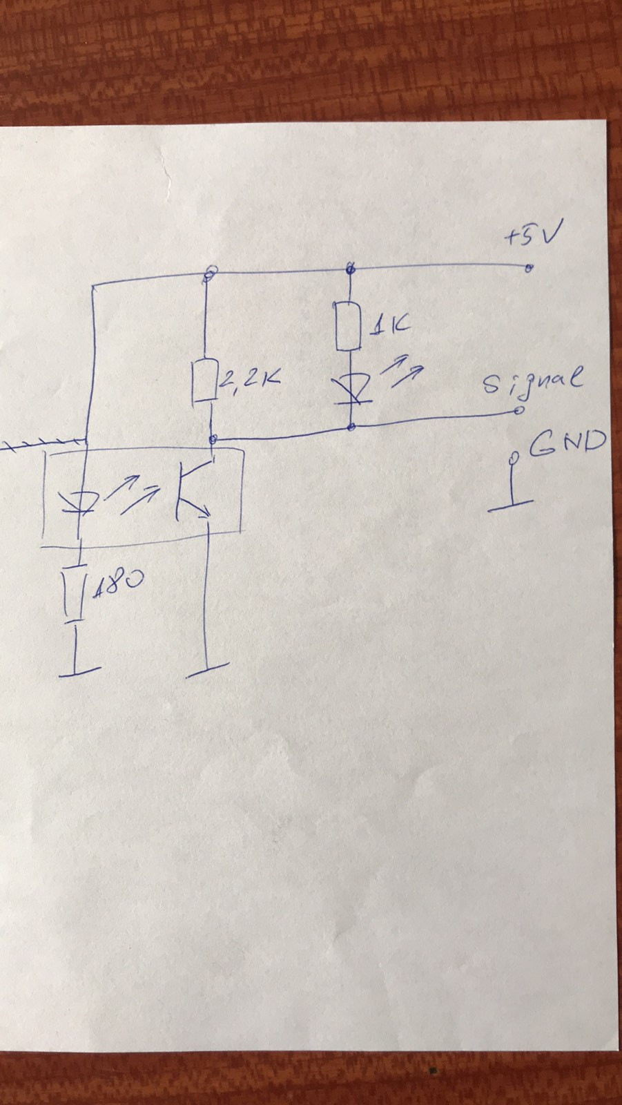

Good. But that's the sensor. What is the circuitry on that board and what is on your prototype board?
That's the circuit of the limit switch.
The prototype board has only connectors on it so that you can disconnect limit switches and drivers from the KLFOP. It has no other components.
That looks reasonable. Although the LED/1K Ohm is driving the photo transistor quite hard at ~4ma. The spec sheet only specifies the output to be below 0.4V @ 0.2ma. So this is 20X over that.
