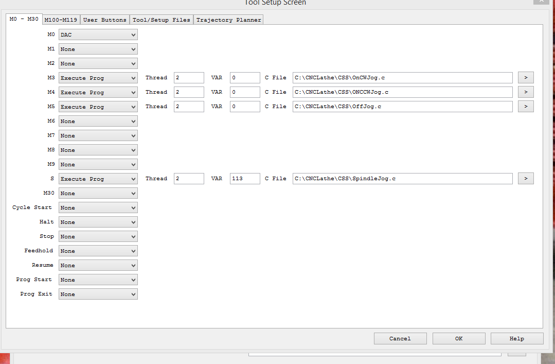

Try setting the Actions for M3, M4, M5, S to "Exec/Wait" instead of "Execute Prog"
Otherwise it might be some mixup in which Variable the speed is being sent and what the Programs are expecting. Please post (attach) all .c and .h files from your CNCLathe folder. Also screens shots of how all the Actions are configured (KMotionCNC Tool Setup Screens).

I tried changing the actions to the "Exec/Wait" settings and KMotionCNC did not seem to like that so I changed it back. What I learned after running the lathe with G code programs is that it seems to run as it should dependably until I add the G96 to the program. I think that is introducing some kind of error into KFlop. Even if I take it back out of the code the spindle will not work correctly until I close out and reopen KMotion. Then as long as I do not try using CSS all seems to be good. I have included the shots of tool settings and I think, the requested files. I included 10 attachments with this and will post again with another 5.

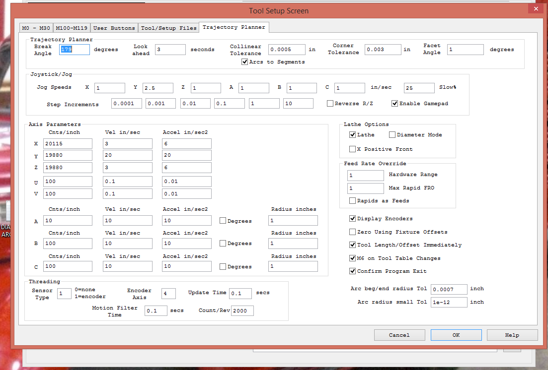

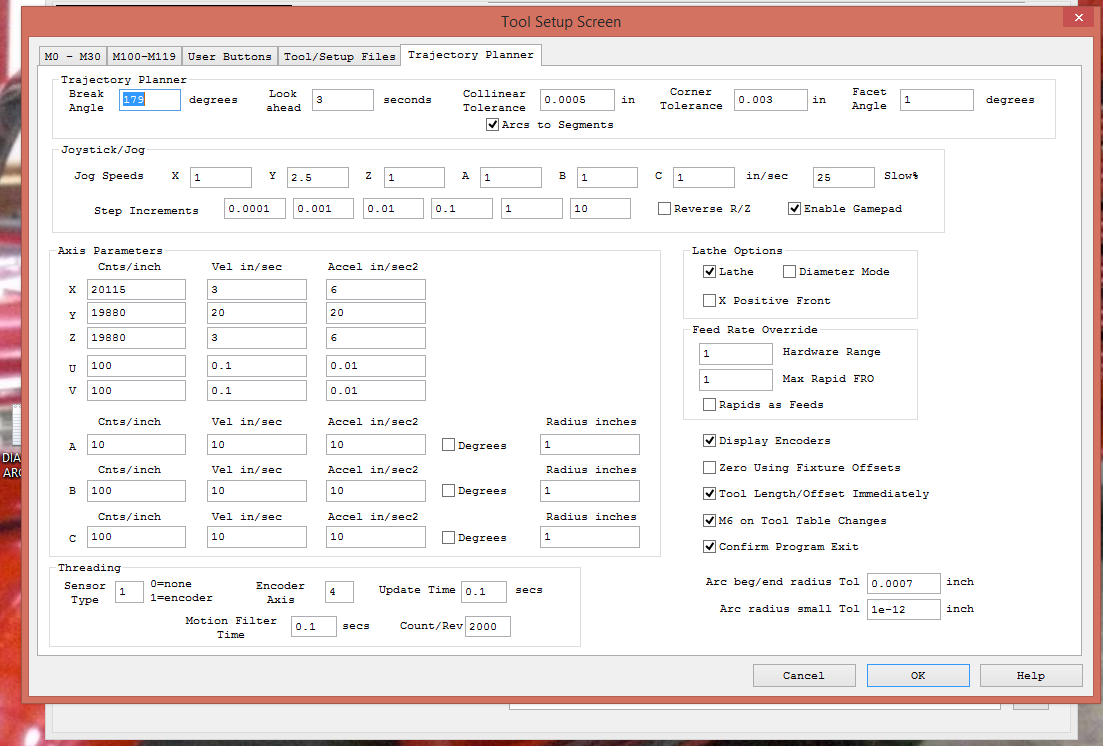

You might try changing X Positive Front option in the Trajectory Planner Settings.

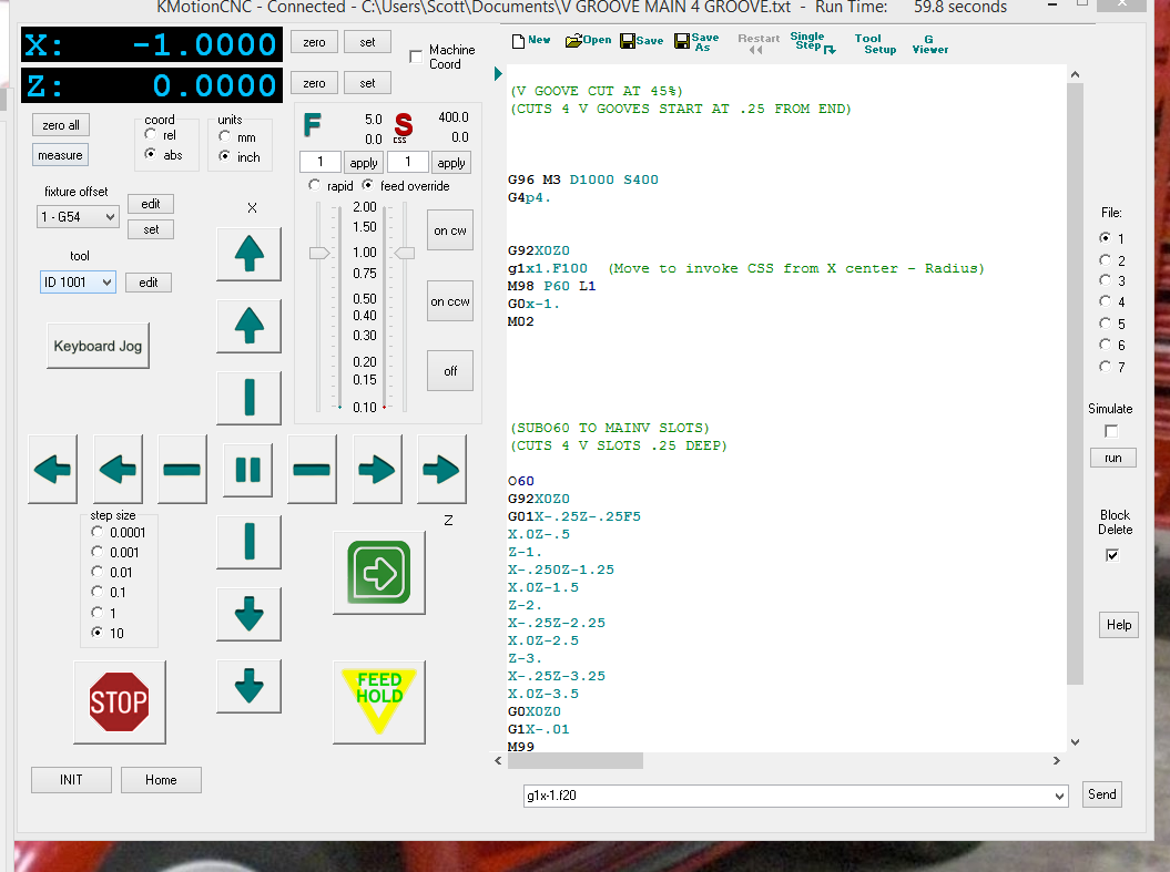

Do you realize that with CSS the rpm varies with radius? Please make a simple example in KMotionCNC to turn on CSS, set an S value, Move X to some radius ie. 1 inch, post the GCode, what the DROs read, and what happens.

I tried the reverse of X in trajectory and that just made X move the wrong way. I was not able to try the test you prescribed because as soon as the G96 code is activated the spindle just goes to maximum speed and faults out on drive.I checked the analog output and it was at 9.96 v. I tied to get Mach 3 running to see what it would do with the code. I think the spindle speed user program you had set up was SpindleMach3Jog.c. I can get that to initialize Mach, but something is not right there. The spindle runs at 7% of whatever speed I enter in the MDI line or the program and I think the moves for X and Z are doing the same. I made sure settings are for Inch but the programs run at a small percentage of what the moves should be in inch mode. Is that the correct Spindle speed user program for Mach? That should be thread 2. Should the Home and Notify programs be on thread 2 also or do they need their own thread?

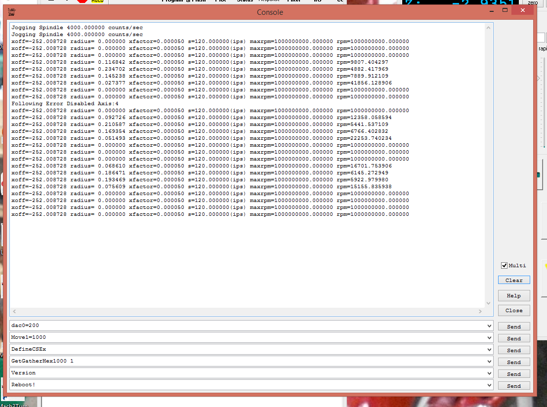

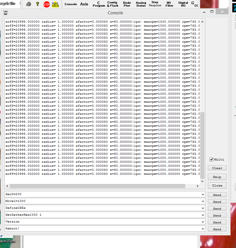

To help diagnose what is wrong make the CSS update time longer and enable the diagnostic print out. Report what is printed on the Console Screen after G96 is commanded. In CSSJog.c change:
#define CSS_UPDATE_DT 0.05
to:
#define CSS_UPDATE_DT 2.0
and remove the '//' from this line:
// printf("xoff=%f radius= %f xfactor=%f s=%f(ips) maxrpm=%f rpm=%f\n",*css_xoff,radius,*css_xfactor,*css_s,*css_max_rpm,rpm);
Regarding Mach3 let's work on one thing at a time. But seems like for x or y the steps per unit or units are not set properly.
Regarding Threads: a Thread can only run one program at a time. It is not normal to home and change spindle speed at the same time so they can use the same Thread, but to be safe you might use separate threads as you have plenty available.
okI tried the reverse of X in trajectory and that just made X move the wrong way.
Please perform the test anyway. It doesn't matter that it faults out. I just want to understand exactly what you are doing and what happens.I was not able to try the test you prescribed because as soon as the G96 code is activated the spindle just goes to maximum speed and faults out on drive.
to:

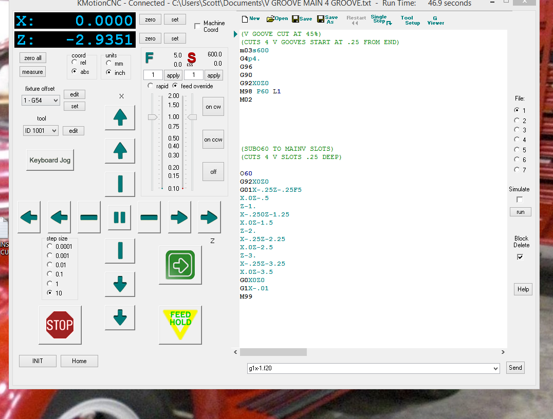

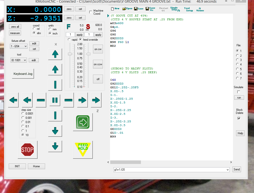

Hi Tom,Here is my attempt to provide what you need to see. This G code just sets zero and then advances in X from the start point. If you need me to run a different sort of program I can. Thanks for clarifying the threads question. I was not able to catch the KMotion screen before spindle faulted out, so that is a still shot of the program ran.

- Posts: 2892
Re: Messed up program access
Hi Scott,
Ok it is now clear what is going on. Because the test starts out with a radius of zero the RPM should be infinity. Since infinity is not possible the maximum RPM should be used. But there isn't any max RPM specified in the GCode. In this case the default maximum of 1 billion RPM is used. Obviously the system can't do 1 billion RPM and soon faults.
Specify the max RPM with a D word like in the example here.
G96 M3 D2500 S159.6 (CSS should be 1000RPM at R=25.4mm)
I suppose we should change the C Program so that if the Operator forgets to specify the maximum some better limit is used. You might add a line of code in CSSJog.c to add an additional limit check. Change:
if (rpm > *css_max_rpm) rpm = *css_max_rpm;
to:
if (rpm > XXXX) rpm = XXXX;
where XXXX is the max possible RPM you ever want for your system.
Another option would be to display an error message for a max RPM over some limit.
to:

Thank you for your wisdom again. I changed the C program as per your instructions and that fixed the spindle faulting problem. I feel like it is really close to 100% again now. I changed the G code program to move to start at X 0 and then move to a 1" radius. If I understand correctly that should invoke the CSS. I have included a shot of the G code and the console print. Once in a while the CSS is applied correctly and the spindle speed changes as it should. The red speed change indicator acts correctly all the time. When the X axis is moving in toward center it shows the speed increasing and visa versa. Most of the time the speed never actually changes and the analog screen shows the DAC output for the spindle as a steady voltage. There seems to be an arbitrary disconnect between the command and the function at KFLOP. Does this bring anything to mind that I should check?
