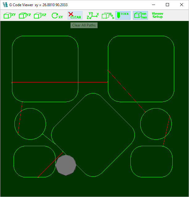

So I had the same issues and am using a Fanuc style post I believe. I was glad to see this post and was able to download the setup file that Tom posted which resolved the gouging and concave corner messages for me.
However, now I have constant errors with G03 moves, each one popping up with "Tool radius not less than arc radius with comp."
Am I missing something else? Changing the post processor is possible but not as easy for me to do as working with KMotionCNC if there is something easy that I am just missing.
Below is a short test example of code - it is using a 12.7mm endmill with an actual diameter of 12.72mm that is stored in the tool table. Let me know if you have seen this issue and how is best to resolve please... Appreciate the help!

Hi a_j_p,
It isn't clear to me what you are trying to do. Are you trying to cut pockets or leave material standing up.
Here is a plot of the GCode with no compensation which should show how the material should look after the Job runs.
Also shown is a tool with diameter 12.72mm.
If you are trying to cut pockets the tool is too big to fit in radius.
If you are trying to leave standing material the tool will gouge the adjacent material.
What are you trying to do?
