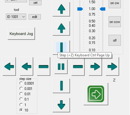

I noticed that when in Trajectory planer setup page "diameter mode" is selected, in KmotionCNC screen button "step"

for X axis reacts in same manner, if the "diameter mode" have not been selected. I mean in diameter mode when step size is selected 0.1, axis X should move in fact for 0.05. Not big deal, but would be more comfortable to work with manual steps.True coordinates, step

Thanks for reporting the Diameter Mode Jog Step Bug. Here is a patch that should fix this. Replace the KMotionCNC.exe within Version 4.34. Please let us know of any issues.I noticed that when in Trajectory planer setup page "diameter mode" is selected, in KmotionCNC screen button "step"
