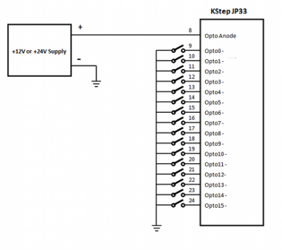

You possibly have noise on the wiring. How is it wired? Those pins need to be driven high and low.
Since you have a KStep it would be better to use the 24V Opto-isolated inputs available on KStep.

That doesn't explain how it is wired.The signal wire of the limit switch is directly connected to KFLop IO34 and IO35.
IO34 and IO35 are high impedance 3.3V LVTTL Inputs. You can not just connect them to a switch. When the switch is open the input will be floating and its voltage will be indeterminate. You might get lucky and sometimes work.The tricky thing is if I keep the two optical limit switches connected to IO34 and IO35 and set LimitSwitchOptions to 0x112 //means just use the positive one. It works perfectly.
IO26 - IO33 have 150 Ohm pull down resistors. These will be guaranteed to be low when disconnected (switch open). So you could use a switch to connect them to 3.3V.
As I said it would be better to use the opto-isolated inputs. Long limit switch wiring running all over the system can pick up noise which will not be isolated from the high speed digital circuits.
