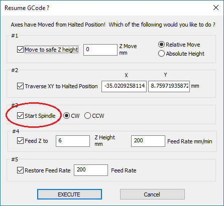

Hi William,
I assume you have a Halt Action defined to turn the Spindle off. Please post it with any included files.
I think the issue might be the Resume | Start Spindle:
which performs an M3 which is expected to turn on and go to the last commanded speed. But then if the Halt Action results in the last commanded speed being 0 then the spindle won't come back on.
Does this sound correct?
