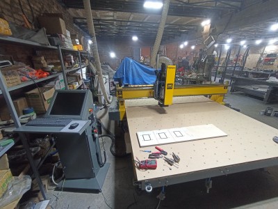

I want to show what I'm working on.
Here's a video of the problem.
https://www.youtube.com/watch?v=0Q77vpXCm3Y
