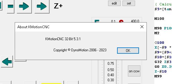

What Version are you using? Post Screen shot of About Box. (right click Title bar)
turbothis
Posts: 331
Location: southern oregon
Re: no toolpath and tool shape is backwards
Post by turbothis » Wed Mar 20, 2024 8:38 pm
ok let me go look.....
i just deleted Kmotion on the office desktop
download the newest and YES it now works on that one
turbothis
Posts: 331
Post by turbothis » Wed Mar 20, 2024 8:41 pm
only .1 behind right?
is that enough to kill this?
