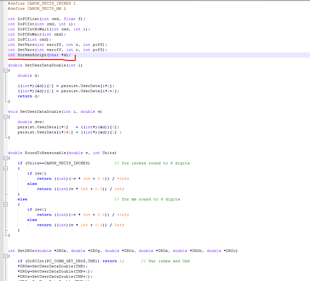

Tarasevih
Posts: 101
Joined: Fri Jul 09, 2021 11:26 am
Re: C program streams
Post by Tarasevih » Wed Mar 20, 2024 7:11 pm
Hi Tom.
I figured it out Tom.
The problem was that the function was not added to the prototypes.
I added it and now everything works.
Taras.
Posts: 2676
Post by TomKerekes » Wed Mar 20, 2024 8:02 pm
Very strange. The function is defined later so a prototype should not be required as the function is fully defined before it is used in the main program.
But I never argue with success :)
