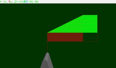

Post by turbothis » Fri Jan 26, 2024 6:45 pm
interesting
at 29 degrees it sure looks like 45 on the g viewer?
( threading starts at Z zero )
G20 G18
G00 X0.5 Z0.0  ( Clear plane )
M04 S500       ( Set spindle speed to 500 RPM )
G04 P3         ( Dwell for 3 seconds )
#1=[0.0025]    ( Depth of Cut )
#2=[0.40]     ( Total depth of thread )
#3=[0.560]     ( Length of thread / start position )
#4=[0.0394]    ( Thread pitch / per rotation )
#6=[-29]        ( Desired angle in degrees )
#9=0           ( DOC so far )
#10=0          ( Cumulative Z-axis movement )
( Calculate the Z increment based on the angle and DOC )
#5=[tan[#6] * #1]  ( Increment for Z-axis per pass )
M100
M98 P100 L[#2/#1]  ( Number of passes = total depth / DOC )
M2
O100
X-#9
#9=[#9+#1]       ( Increment DOC )
#10=[#10+#5]     ( Increment cumulative Z-axis movement )
G32 Z#3 F#4
G0 X0.200
Z-#10            ( Increment cumulative Z-axis movement )
M99
turbothis
Posts: 331
Location: southern oregon
Re: threading macro help
45 looks pretty flat
Posts: 2892
Post by TomKerekes » Fri Jan 26, 2024 7:43 pm
I think you have X in Diameter mode. In that case you'll have to move X double.
X[-#9 * 2]

Post by turbothis » Sat Jan 27, 2024 1:45 am
thanks as always
