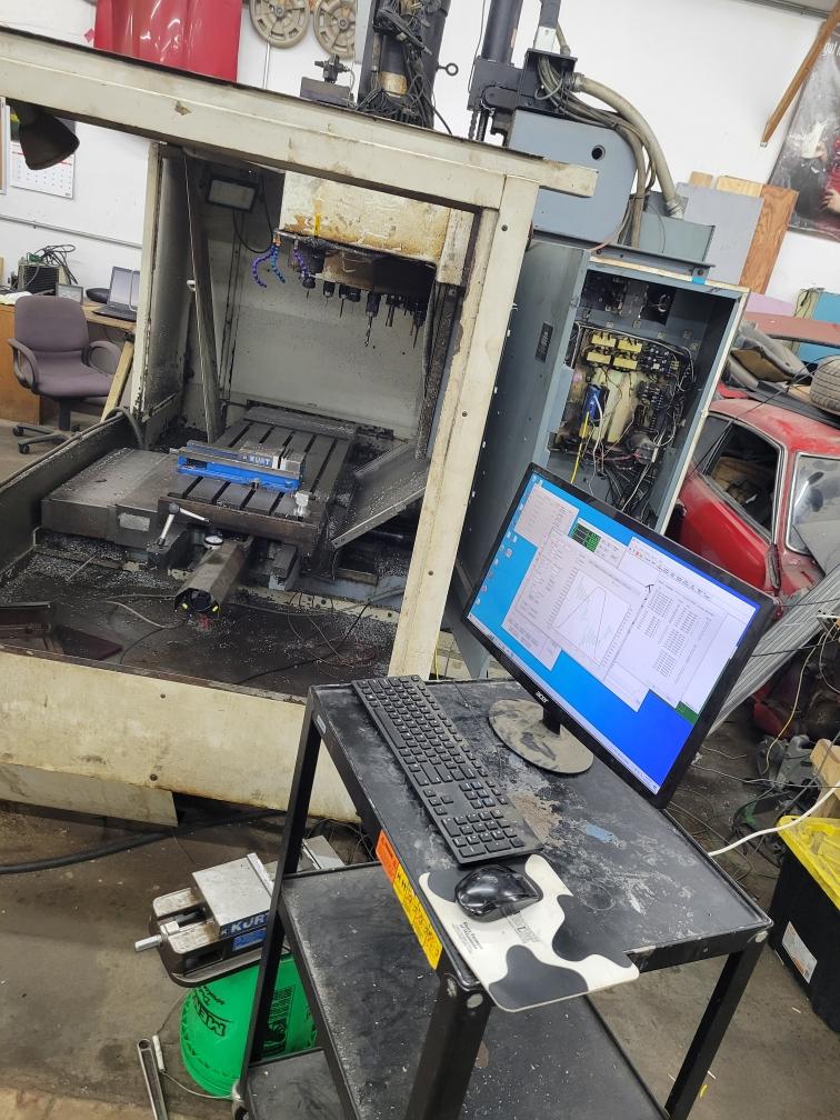

2 years back I picked up a 1992 Fadal 4020; 28-inch Z axis, 10k spindle, DC servos. I had a cart full of Dynomotion boards but started making parts with a drip feed to the old CNC88. Present day: everything was going fine until my X-axis resolver started on the fritz. The cabling looked rough as well. So, I ordered about $1k in parts from Cali to make it right. As I was waiting for parts to show up...the wait got the best of me. I didn't want my Fadal "Fawne" to be trapped in a wait-for-old-yet-expensive-parts-ecosystem. To my surprise; that shopping cart still had the Kflop, Kanalog, and Konnect boards waiting for me! Click.

Well, plans for the servo drives have changed drastically. Through some more researching, I have finally settled on some drives. New ones. Junus JSP-180-30 from Copley controls. 100% digital drive, 15 amps continuous, up to 180V DC supply voltage. They seem to offer some unique oppurtunities but I won't get into that until I get a chance to test them. What really excites me is that they are modern and off-the-self. Don't have to rely on eBay or others for parts.
With the conversion, progress has been made. The old controller and OP have been removed and sold. Kflop, Kanalogue and Konnect boards are mounted inside the cabinet along with the ribbon cable breakout. Tach/resolver cables pulled and encoder cables have been run. All 3 servos converted over to the encoders mentioned above.

The X-axis is setup! Well, mechanically. With the motor wired just with power in a vice on the floor I attempted to setup the motor with the drive. Took a long time to get the software to connect. (Recieved an email back the next day from Copley support saying support was 'forgotten' for my series drive. By this time I had found a legacy version that was working well with a legacy version of the usb-rs232-rj11-rxtx setup I was rocking. This non-support issue has been fixed in their next version I am told.)
Once connected, the setup went real smooth. Put in motor spec and hit autotune. No dials or pots to tweak! In 5 minutes the values for the torque loop in the drive were spot on. It also calculated the proper signaling bandwidth to use. A little over my head but I thought it was fancy. I attempted a step response move.

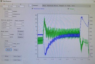

Tuning of the X axis, +/- 20 encoder counts speed set to 400 IPM if my math is correct. I am pretty happy with it. However, this being my first tune, if I missed something obvious let me know.

Very good. But several things:
#1 the Acceleration is set extremely high relative to that level of Jerk. Jerk is normally set around 10X the Acceleration value in order to to apply the full acceleration in around 0.1 seconds. With those levels of A and J it would take 200 seconds to apply full acceleration. And by this time the max V would be far exceeded. So the acceleration is entirely jerk limited (triangular rather than trapezoidal). There is nothing necessarily wrong with entirely Jerk limited motion but mainly the A value can be misleading.
We have an included tool called TripsWPF.exe that will plot acceleration with any parameters. Here is an example with your settings:
Notice the A ramps to a little over 1e6 before needing to ramp back down. You might try reducing A down to something like 1e6 and then increase J to see if performance improves.
#2 You didn't post the IIR Filters Screen but I'm guessing the filters are all cleared. Notice the Output (green) has something like 150 count spikes in it. This is because with D gain of 150 each encoder count change causes a 150 count impulse. Often the Amplifier can't react to this and effectively smooths out the spikes but adding a 2nd order Low Pass filter of around 500Hz Q=1.4 should reduce the spikes. (This is normally placed in Filter #2 so it also applies to feed forward).
#3 The largest error occurs as a lag during the acceleration and as an overshoot during deceleration. Acceleration Feed Forward might be able to reduce this. Start with a very small number and increase until the initial lag is reduced as much as possible without causing a positive error.

Tom, thanks for the insight! That Trip States program seems quite nifty.
1) I will spend some more time with the J and A values.
2) Correct, my IIR screen has zeros across the board currently. Will get the 500Hz Q=1.4 added to FIlter #2.
3) I was actually thinking about adding some feed-forward! I have just not gotten to it yet. In day-to-day use I doubt the machine will ever have more than 200lbs on the table so could use 0-200lbs of table weights as a 'proving range' for feed-forward values.
The tuning of the PID took me a while to get to those numbers because they were way bigger than I thought they would be. 75 P and 150 D just seemed really large to all the other examples I have read through.
Even with these large numbers, I was getting an error plot with a lot less error than the OE drives so was quite pleased.

Bumped acceleration down to 1e6 as suggested. Increased Jerk to 5e7 on all axis.
Added 500 hz Q=1.4 Low Pass 2nd on Filter 2 for all axis.
Found out that the mechanical slop sound in the Y axis was actually the guard slapping the frame from an untuned servo.
Went through and re-tuned all axis. The X took hours again...but once I got the hang of it, the Y and Z went quick (max speed was lowered for the z axis). Now running +/- 8ish counts with feed forward! Very happy with these results. The encoders have 40,000 counts per inch so 'digitally' we are +/-.0002 accuracy. Now, between the coupler and the ballscrew I am sure there is some backlash somewhere but to be dialed in at the servos is really building my confidence on this retrofit.
