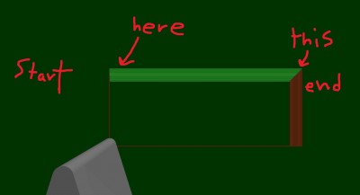

chatbots got me mostly there but i cant get the Z increment on the start side of the cut
( threading starts at Z zero )

I think at the end instead of always moving Z back to 0 move to #10

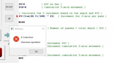

i had chatbot modify it further to make it more user friendly in that an angle can be directly input and the macro would do the math but i think it is too much as it does not work

GCode trigonometric function parameters are in degrees not radians.

Just remove the * 0.0174533 (PI/180) which is converting from degrees to radians

what is the (PI/180) ?

Pi/180 = 0.0174533
It's how you convert between Degrees and Radians.

oh boy i made it angry again
