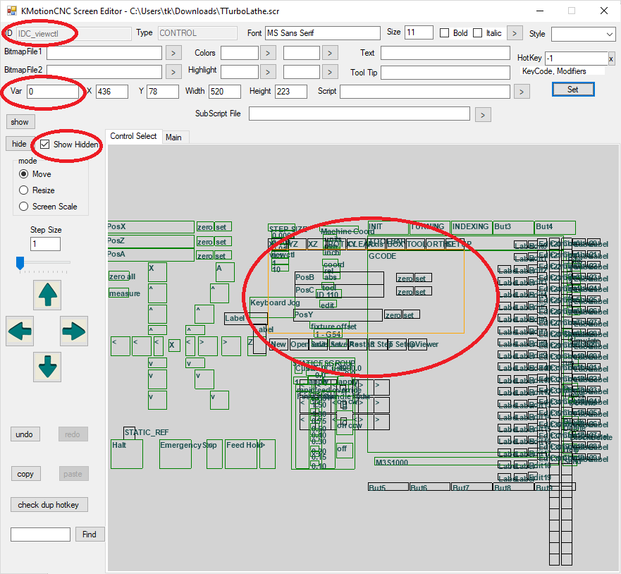

am i needing to put your .exe in that?
no
You need to use the Screen Editor on your Screen.
Use Show Hidden so you can see the GViewer Control.
Select the GViewer Control
Change the Var Parameter from -1 to 0
Click Set
Save the Screen File
Restart KMotionCNC to re-load the Screen
also i noticed my program is backwards
I think you want the Option | Tool Setup | Trajectory Planner | Lathe Option | X Positive Front

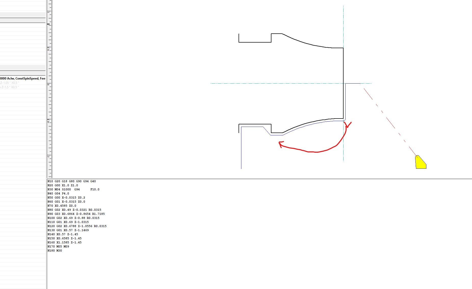

Post by turbothis » Sun Jan 18, 2026 1:34 am
holy cow i am back here again!
took off the DC servo for the spindle.
got the vfd running just fine on the old motor
i got no g code viewer and the radius cut is backwards. i dont recall what i did to fix this or even why it is happening again :|
i can not edit any text in the G code viewing window on KmotionCNC too.

G code and CAM preview
the red line is what the machine tries to cut
